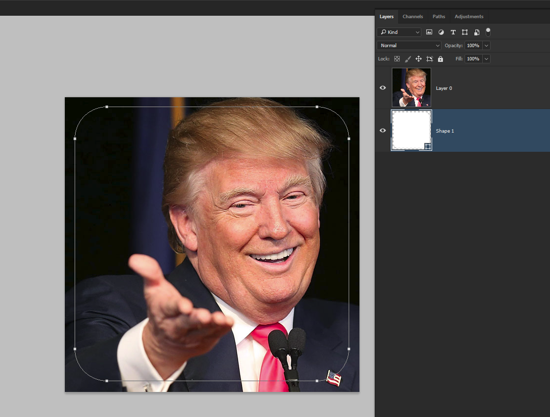

4) Draw on your image. You can constrain the dimensions should you want to
5)Now just reverse the layers -You may need to unlock the image layer if it is the background. You can see the vector path below

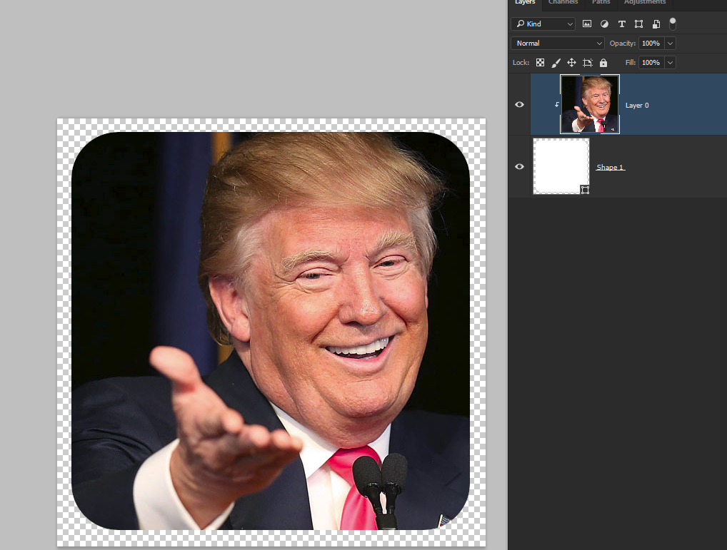

6) Now the clever part go to the layer menu and with the upper layer in this case Mr Trump selected, click on Create Clipping Mask.
7) This will place the image inside the vector frame. You can't actually make the corners rounded but you can make it look that way.

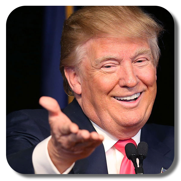

8) If you want to get fancy you can add a new layer filled with a color so the checkerboard transparency disappears and then by selecting the shape layer you can apply a Layer Effect. Below I just added as drop shadow.
You will end up with something like below. Hope that helps.
