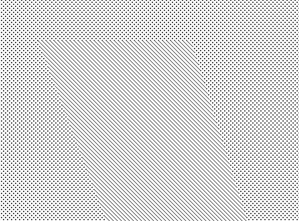

A sample image link follows. Flatten the linked sample and convert to bitmap mode at 2400ppi using 50% threshold method.
Test print at the highest resolution available at 100% magnification/same size.
This uses a background "stipple" of 45° round dots at 120 lpi frequency.
The text is using a "line" pattern at 45° at 120 lpi frequency.
It will take a lot of experimentation, trial and error. It will depend on your out
It will take a lot of experimentation, trial and error. It will depend on your output variables. You may need to increase or decrease the frequency of either the text or the background pattern, and or change the screen angle etc. Perhaps a horizontal line angle is better than 45°, I really can't remember... You really need accurate, high-resolution reproduction.

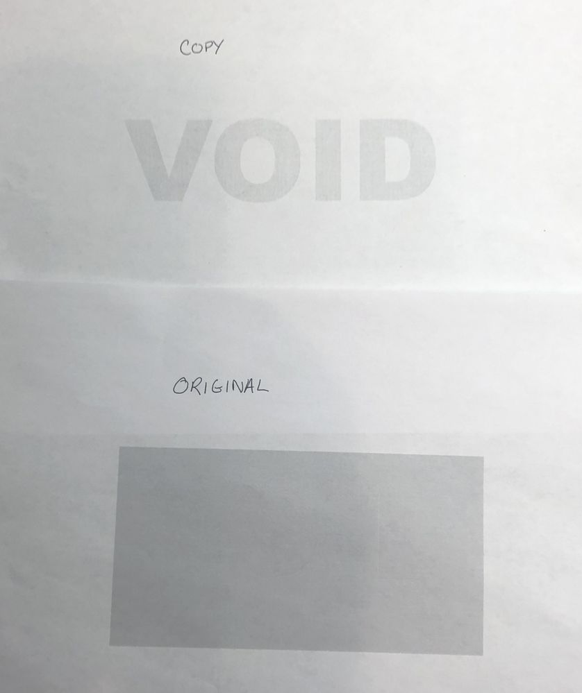

The file you provided is INCREDIBLE! I printed the file out on our color laser printer (Phaser 7800) as-is and it didn't work very well (I didn't read/do what you instructed) as the grey box and VOID both printed although the text was just slightly visible against the background. I put the print on the copier and the text did pop out a little more. So it KIND OF worked. I then studied the file and thought maybe if I connected the end points of the lines to the dots with the brush tool it would prevent the text from being visible at all on the original, but even with it set to 100% hard edge there was some blur to the brush. So I converted it to bitmap 1200 dpi / 50% threashold and then connected the ends of the lines to the dots adjacent to them (no brush blur). I printed it out and all I got was a grey box, couldn't see anything else. Put it on the copier....BAM!!! No grey box, just "VOID" appearing on the paper!!! WOW!!! JUST WOW! Thank you so much!
Grateful for your help friend!

The file Stephen_A_Marsh posted above is what I used. It's layered showing you how it's done.
Now...if you're ONLY looking for the word VOID I would suggest using his file that I modified which you can DL by clicking HERE. It's a flattened TIFF that I cleaned up a bit (removed white edge from the letters) by connecting the ends of the lines to the adjacent dot. I think it could use a titch more work in 4 spots, possibly DISCONNECTING the ends of the lines from the dots to remove the black/darker edges, which I think beleive would make this PERFECT!
This is hands down the coolest thing I've seen in 2019 and honestly perplexes me how it works. I suggest printing my file on your office printer and slapping it on the copier, please reply with your reaction. 😃

Best not to resample.
Create the image at final 100% or 1:1 print size at a high resolution so that the halftone dots are properly formed.
There may be a trade-off in the coarseness/fineness of the LPI frequency used.

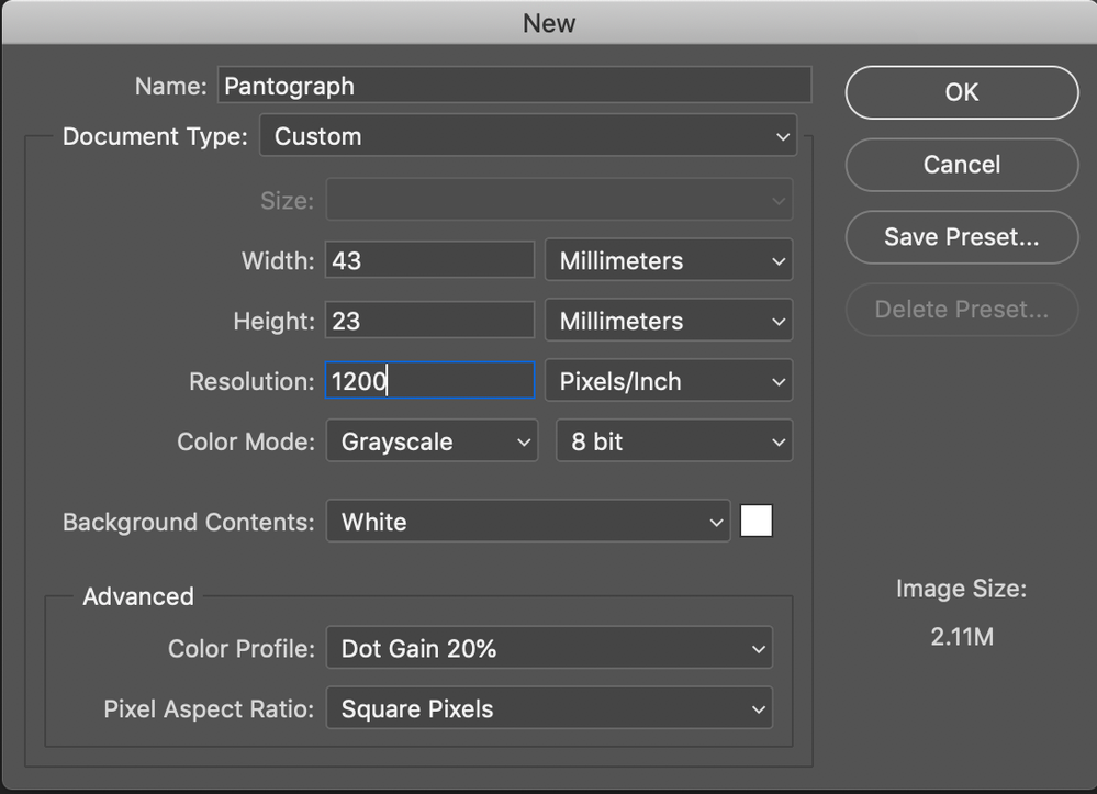

Your PDF has some issues.
As previously mentioned, the resolution needs to be very high for bitmap mode halftones, ideally 1200 ppi or greater at 1:1 print size. The final image mode should be bitmap, not greyscale or RGB etc.
Your sample is approx 44 x 23 mm in size.
This would create an image around 2100 x 1050 px in size @ 1200 ppi for an approx. print size at 1:1 scale of 44 x 23 mm metric size.
It is critical that no resampling or colour mode changes are made from the final 1:1 sized bitmap mode image and that page layout software does not change the Photoshop 1:1 size.
You would need to test the lowest PPI value that produces acceptable results for the output size, device resolution and printing process.
