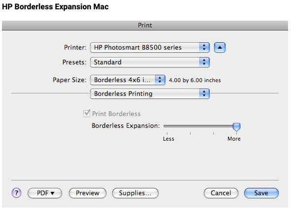

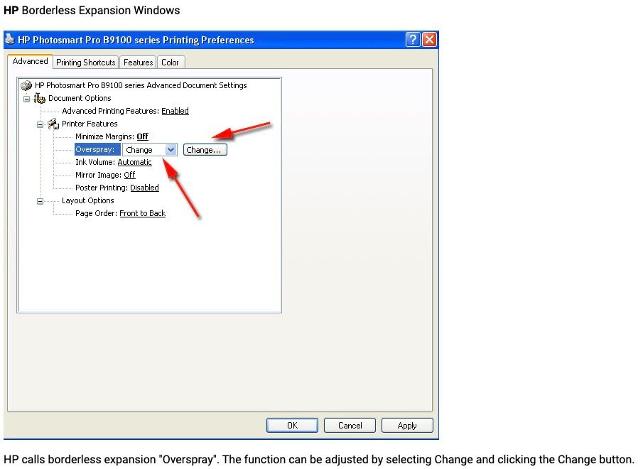

Hi AntoniaAgain ;~}, thx for more detail. However it is right that for borderless printing [on Epson at least] the image is slightly upsized, so slightly cropped - I agree, though, that should not result in a whole lot being cropped off.
When you see your print IS it actually borderless (i.e. printed bleed on all edges?)
If you're returning the HP machine, why not get an A3 model, then you CAN print 8.5 x 11 on a larger sheet [and trim] without selecting "borderless?
This may be helpful:
https://www.redrivercatalog.com/infocenter/tips/inkjet-borderless-expansion.html
And for Win users
I hope this helps
