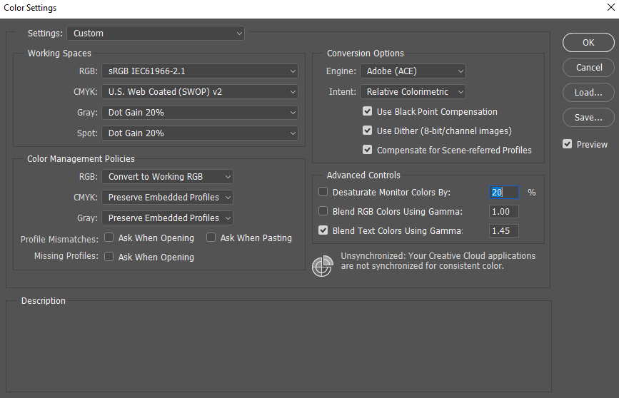

What is the original image’s Color Space?
How exactly did you create the gif (Save As, Save for Web, …) and with which exact settings?
Where are you viewing the resulting gif?
Please set the Status Bar to »Document Profile« and post more meaningful screenshots of both the original and the resulting image.

-i cant understand what do you mean by image color space?

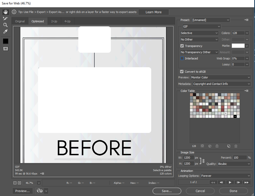

May 27, 2018 May 27, 2018
Why only 128 colors?
Then you may want to read up on Color Management.
I asked for screenshots with the Status Bar set to »Document Profile« which would have shown it anyway.
Does the original image have its Color Profile embedded?
Jun 09, 2018 Jun 09, 2018
So you might want to try to answer the questions you have been asked and post the requested screenshots.
Have you read G.Hoffmann’s post?
Basel
The answer is in G.Hoffmann 's post
Your before image contains gradients which to be "gradual" contain many shades of colour. Your GIF is limited to using a range of colours set out in a colour table. With the wrong settings you will see visible steps of colour (bands) - even with the right settings there may still be some colour banding but less significant and dithering (adding noise) can help hide it.

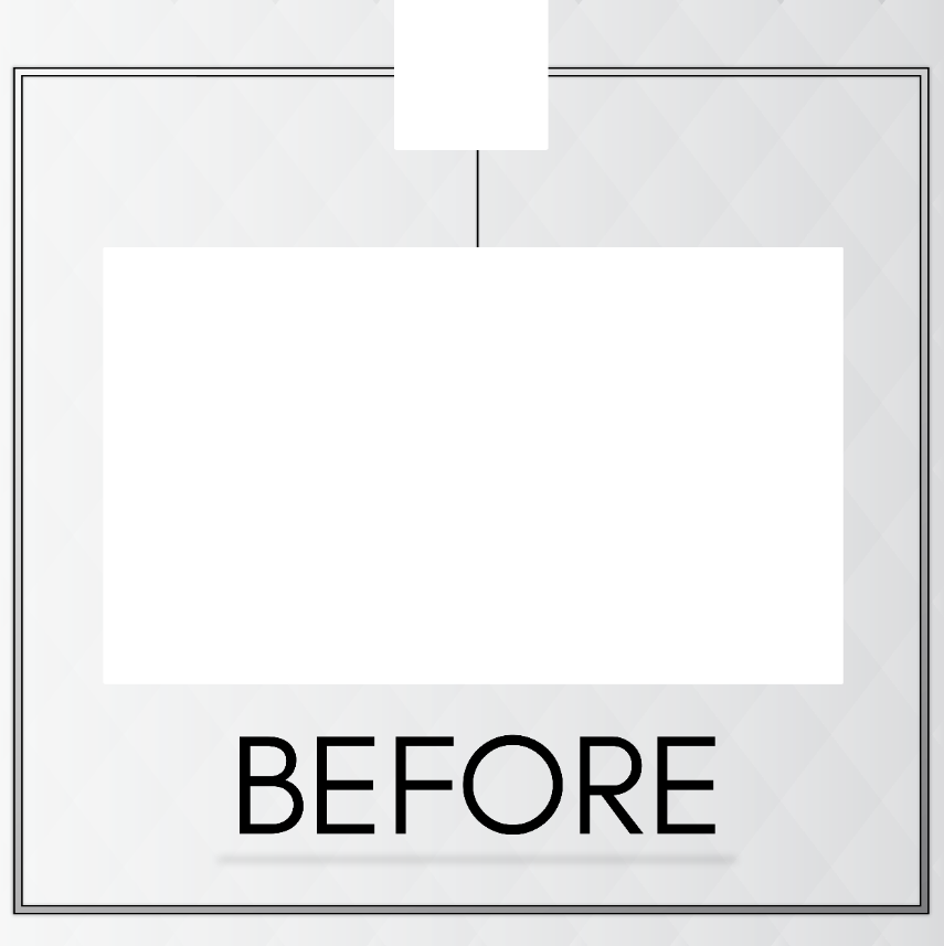

Original image :-

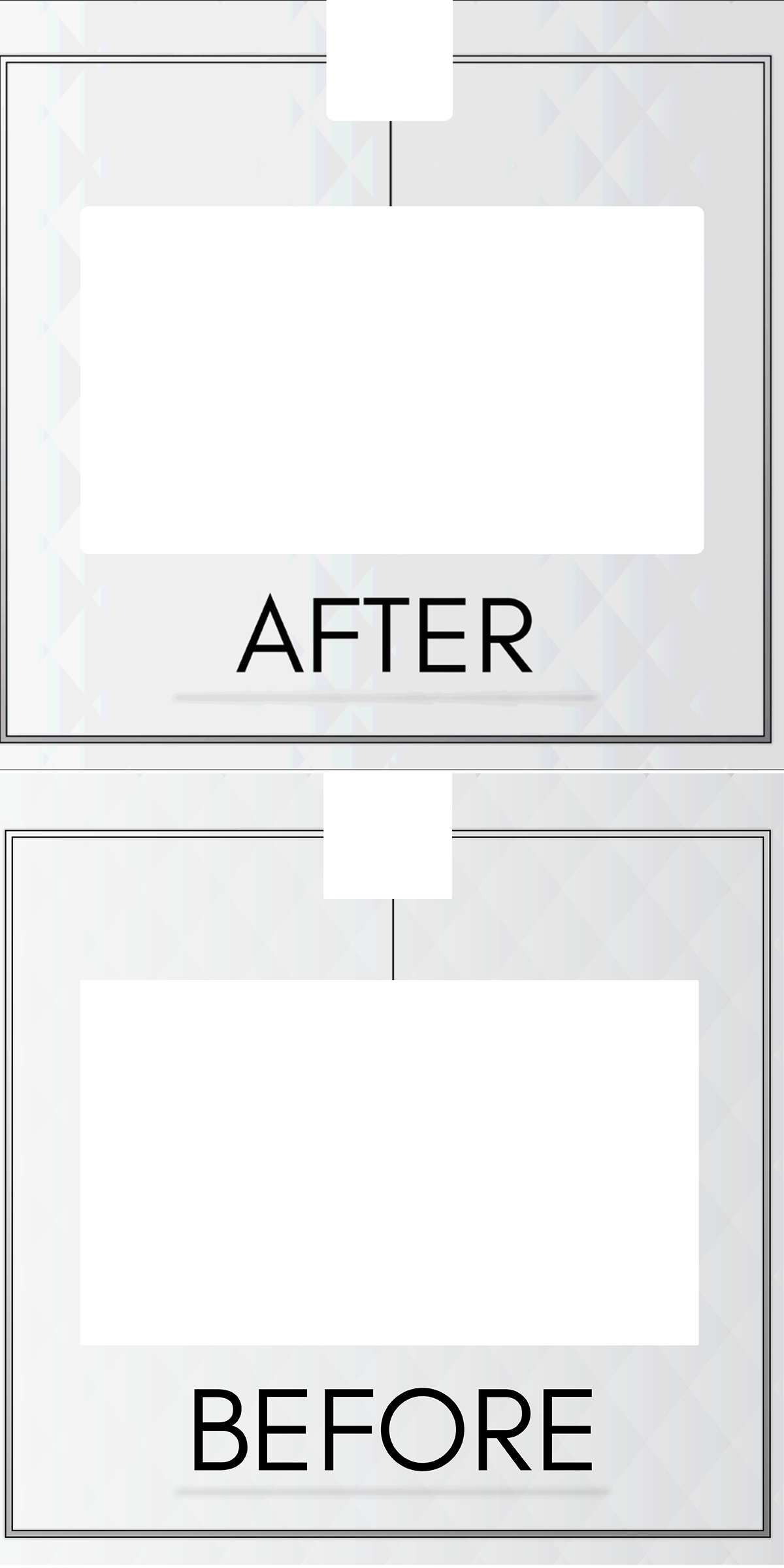

Community Beginner ,
resulting image :-
