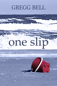

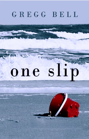

This is for an ebook cover. Someone else did this tint:
and I really like it.
I tried to recreate the same tint and gerrymandered around trying a lot of things including levels, midtones, brightness etc etc. In the process I lost some of the sharpness of the waves and the the waves were too white (I lose the overall tint) and my sand is lighter than his. Here's what I did.
I have lately been experimenting (I have PE2019) with Layers>NewAdjustmentLayer>PhotoFilter>Ok>"Color" radial button>clicking on color square
and then clicking on the color palette to try to find the guy's tint. I have been unable to even come close.

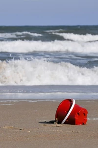

Here's the color in the original image.
If anybody can find the right tint and give me a Hex code to enter I would be very appreciative. (Or if you have another way of getting there.) Thanks.

Thanks a lot, hatstead, but I already tried that. For instance, where do you place the color picker? I tried all over and wherever I pick, the tint just seems faint, and it doesn't get the sand darker. What I think I'm missing in mine is the blue tint on the waves. Maybe I'll select the waves and try to tint them, because really, looking at mine, besides that, it's pretty close to the guy's. Appreciate you responding.

Wow. Thanks so much, Hatstead. One little glitch, when I did the inverse selection (because I wanted to keep the bucket red) for the selection, it tinted everything, including the bucket, blue. (I'm sure I did something wrong.) But when I just selected the bucket and followed your instructions I was able to move the bucket layer above the Hue/Saturation layer and it showed up red. I wasn't able to get really close to the color/hue I wanted. I seemed to need more gray, and when I brightened it, it just looked washed-out, but this is definitely what I'm after. I'm going to sleep on this version and I may even like this more than the other in the morning. Thanks for hanging with me on this.

What happens when I follow your workflow with my original image is this:
And I need the bucket to be bright red, so that's why I selected the bucket before I followed your workflow. And so since I wanted to tint everything but the bucket I thought I needed to select the bucket and then do an inverse selection so that only the area outside of the bucket would be tinted.
Regarding the "washed out" comment (my bad) I was referring to trying to get the proper tint of blue and that by using the brightness adjustment (making it brighter) the blue tint turned to a light gray and looked washed out.
