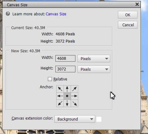

    Go to Image>Resize>Canvas Size (Alt+Ctrl+C) and put the new dimensions in the New Size boxes.  Click OK and the image should be cropped to your desired pixel dimensions.

    Hey Greg, Question, though, your method is just cropping the image, right? (Since it's under the "Resize" category it's got me wondering if it's just resizing the image.)
    Yes, it is cropping the image to the requested dimensions.  It is not simply scaling the image.
    There were several reasons why I suggested the Resize option rather than the crop tool.
    First, the crop tool options really only provide an aspect ratio based on the WxH dimensions.  So, the dimensions of the image are not really constrained,  only the aspect ratio is.  Given the pixel dimensions of the image and the very small crop that you wanted to make, it would be very difficult to drag over the image to retain the specific pixel size of the image.  And because it is so difficult to see the crop box over the image, I'm not sure whether the crop default constrains from a side or the center which I understood was the object of the question. If you have the suggested crops option turned on, it looks to me like the first suggestion does crop the WxH pixel dimensions from the center, but I couldn't be sure in my quick experiment.  Obviously, the other "suggestions" merely fulfill an aspect ratio crop which is not what you wanted.
    Another major reason why I didn't suggest the crop tool is that the default crop ratio is measured in inches.  You would soon learn this if you entered "1800" into the Width text box, since you would likely receive an error message such at this:
    The only way to get around this is to type "1800 px".   However, I found this to be buggy on my machine and it crashed the program several times.  (I have reported this problem through the Adobe Crash Reporter.)
    Given these problems, and my assumption that BadStar had probably already tried the crop tool, I thought the Resize>Canvas Size was a simple and elegant solution.
