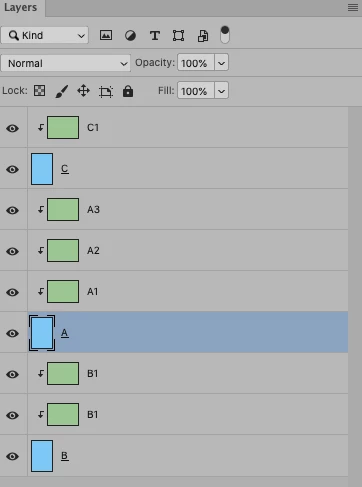

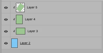

How to release clipped layers with javascript? I need to write a script which will release all clipped layers.
P.S. Number of clipped layers are not always 3 (like on example below)
Correct answer Stephen Marsh
Ok, below is an example.
P.S. Structure of layers is different case by case, also names of layers are not definded.
OK, so layer A is selected. What now? Is it that A1/A2/A3 should then be unclipped, while the clipped layers of B and C remain unchanged? What you require is not clear to me...

Thanks, this works, but this script release all clipped layers on a file. Can I limit this function only on selected layer?
Stephen Marsh
May 21, 2020
You didn't specify that it should only be selected layers, just that the number would be variable... I'll see what I can do, but no promises.
EDIT: The previous code that I first posted works on selected layers, however, there are limitations. Can you post a cropped screenshot of the layers panel with the exact layer structure and selected layers?
