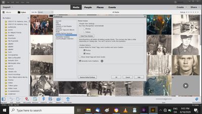

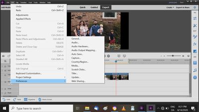

and shame on me for not having looked at your video before asking another question. I followed your instructions on your "getting started with keyframes" video and that way I was able to zoom the way I wanted - from the middle of a portrait to the whole portrait. Thanks a lot for your advice, keyframes is a great tool! I followed also your video on panning and zooming you gave and was able to turn off the default times in the settings of pan and zoom. So now it seems to work so that it won't automatically add more seconds. It is a great help! The only problem is this - I have Adobe Premiere Elements 2020 and there is no such thing in the menus as "Auto Analyze" under preferences or in other menus. So I can't find anyplace to turn off face frames and that is still a problem, extending the clip time.

 Steve, I would like to add that you should turn off Elements Auto Analyzer. That option is turned off in the Organizer. You can't turn it off from within Premiere Elements user interface.
That analyzer takes up huge amounts of CPU time, interferring with all applications you run, not just Premiere Elements. It starts up by itself when you start Windows.
I found in the Organizer Preferences Media Analyzer tab and there could select turning Automatic Face Recognition off. But it won't help in the video editor, it still puts it full of new face frames whenever there is a picture with faces and I open the Pan & Zoom tool. So the problem is still unresolved, and it would be nice to know how to bypass it. Not for me only, but for others who have the same problem.
The good news is this: thanks to your advice, I quickly learned how to use key frames and I see that I am able to do all the panning and zooming and so forth without using the pan and zoom tool and it won't add any extra seconds or anything. In that sense the problem is solved, thank you, but if it is possible to turn this Auto Analyzing thing off in the video editor, I would do that also. Thank you.
