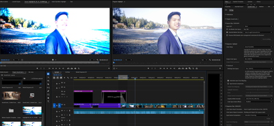

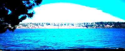

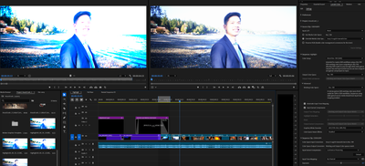

Below screenshot shows: Picture in Program Monitor (Right Side: which I spent loads of time editing based on) and a exported frame (Left Side: this is a single frame, but I'm trying to export video too and the whole video looks like this)
I was thinking the export video option labeled "Match Sequence Settings" would work but, every export option I've tried is producing colors like the one on the left.

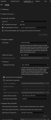

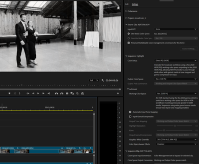

default6g0k7me9sj4z_0-1724999976297.pngdefault6g0k7me9sj4z_1-1724999983856.pngdefault6g0k7me9sj4z_2-1725000035798.png
many of my clips have these settings, but some have other settings where I clicked on "Preserve RGB" footage (specifically on my iphone footage)
But I've tried numerous export settings and it keeps coming out like this:

A few questions will help me help you. It looks like you've chosen an HDR workflow for color management, and you're currently set up to output HDR video with very bright highlights intended for displaying on an HDR display. Is this your intention? In any event, the preset you've chosen for color management is designed to provide a pass through workflow for HDR media, which is why your source media is clipping so badly.
If not, if you are intending to output a regular SDR clip you should try duplicating your sequence for safety, and then changing the Color Setup drop-down menu to Direct Rec.709 (SDR) which will set that sequence to work more similarly to how Premiere Pro has worked in prior versions. Particularly since you're using titles, this would be the safest way to get what you need.
When you do this, all color adjustments you made while using the prior preset will need to be redone, because grades are dependent on the working color space, which is now Rec.709. However, you'll be in a better position to output the video you need.

Additionally, keep in mind that turning Preserve RGB on results in those clips not being color managed. You may get better results from turning Preserve RGB off on these clips, unless you've tested that and decided you prefer the result of suspending color management for those clips. This setting is mainly for people who want to use LUTs to convert their footage instead of the new color management.

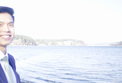

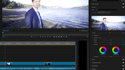

When i convert this footage to rec709, the footage does change, but the clip is still WAY off the mark from that other one.
Also, you mentioned "all color adjustments need to be redone" - that's okay, but I should have let you know that in the original clip, nothing lumetri was changed, except adding a lut in the "creative" tab. All the other color adjustments were made using just these settings here in the dropdowns.
I didn't have to mess with exposure, highlights, anything, the footage came out amazing first go and threw a basic lut on top in creative and BAM, got an image I wanted (viewed from the export monitor) but the exported video itself is just horribly clipped.
You also asked my intention, it to simply deliver a finished video to a client, possibly upload it to youtube and facebook also, but mainly just deliver a video in a google box so they can view it on whatever they want.
How can I achieve the look in an exported video to the one I was aiming for? This Rec709 one is way too bright and lowering exposure, highlights, etc, deosn't come close to what I was expecting....

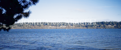

I have the same clip here in my sequence, but it is cut.
I was using a lut inserted in the creative tab of lumetri. I took them off for this demonstration and when I went to look at it just now, I noticed this grayed-out box. I notice it's different "color space"...? But the settings of that clip are identitcal when I go to the settings tab instead of edit.

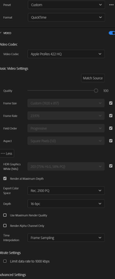

In your export screen please select fomat "Quicktime" and then make sure "Effects" and "Metadata" switches are off.  I am able to export what you see in your timeline with those settings.
Community Beginner ,
Aug 30, 2024 Aug 30, 2024
With these settings?

With these export settings? because I tried these settings, same issue.

I see you are exporting as HDR and I was exporting as Rec 709.

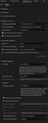

 If you are grading in HDR you really need to enable "Display Color Management" and "Extended Dynamic Range Monitoring."

I've watched your video, and the first piece of advice I would give you is to change the output color space to Rec.709. Even if you like the results you're getting using the Direct HLG (HDR) preset, what you want is an SDR signal, not an HDR signal, and having the output color space set to Rec.2100 is likely messing you up, as it's what's allowing the clipping to happen (in order to output HDR).
Additionally, however, what's really making your footage look better is you retagging it to identify the media color space of each clip (which you can do in batch in the Project Browser selecting multiple clips and using Modify > Color). However, if you want your renders to match your output, you shouldn't change from the Direct Rec.709 preset, that's still the appropriate preset for the SDR output you want.
The HLG preset may show more vibrant colors, but it's allowing signal ranges that cannot be output to Rec.709, so using that setting is what's causing your probem. It's really for outputting HDR. That said, if you've already set up your sequence this way, changing the output color space will tone map everything back down to Rec.709 levels, but you'll likely notice that the output becomes similar to what the Direct 709 preset would have given you, which is correct.
The purpose of the presets is to set up color management to correctly transform and normalize all of your media to the neutral state your camera produced, not to make it look different or "better" (that's what Lumetri is for).
My advice is to stick to the default Direct Rec.709 preset, make sure all of your clips are tagged correctly using Override Media Color Space, don't turn on Preserve RGB for any of your clips (unless you're assigning an input LUT to those clips), and make sure your output color space is set to Rec.709. You can go ahead and customize the input tone mapping and input gamut compression settings of each sequence clip to taste, that's what those settings are for, but leave the Color setup preset to Direct Rec.709.
At that point, adding a creative LUT in Lumetri should work fine, and if you want any particular clip to be more saturated, use the other Lumetri controls.

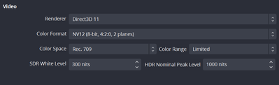

My question @Alexis Van Hurkman is, what is the output of my OBS Record settings? It is NVENC, H.264. and Rec. 709.
What do I mean by this? Well, my OBS is recording in Rec 709 color space, a picture of the program monitor.
The OBS recording, IE the video you watched, is in rec 709. You can clearly see in my rec 709 video that you watched, is correctly showing the correct look in my program monitor. So I cannot agree with you saying that "The HLG preset may show more vibrant colors, but it's allowing signal ranges that cannot be output to Rec.709, so using that setting is what's causing your probem. It's really for outputting HDR." Because, again, my OBS rec709 footage IS SHOWING the frequency ranges in the final OBS recording.
So as much as I'd like to go back and color correct allllll of my footage manually with lumetri panel, manually adjusting the colors, highlights, hues, I love this new feature you guys put in with the conversion luts, and I really do think this is either a BUG or an export setting issue on my end, and not "because my timeline cannot be exported in those frequency ranges...." because otherwise I wouldn't be able to show you a rec709 video recording OF my program monitor showcasing HDR footage... My OBS footage would also be blown out when you tried to watch it, but no, you watched it just fine, in rec709, and all the colors in the video you watched were the correct color frequencies.
If this is a serious roadblock in premiere, couldn't it be coded in a way where I could just record the Program monitors output? That's essentially what I did with obs, which I keep hearing from multiple sources now that HDR footage cannot be in rec 709 color space....?

@jamieclarkeI noticed when I click on "Display Color Management" the program monitor now shows me what is getting exported. I think maybe a bug is occurring in which premiere isn't checking to see if that box is ticked or unticked on export stage, and assumes it's on the entire time.
