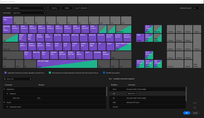

Jul 03, 2025 Jul 03, 2025
Still broken in 25.3.0 (Build 84).
You can see below that I have Zoom In/Out set to "- / =" with Ctrl modifier.
Can confirm, all other modifiers work when mapped to Zoom In/Out except Ctrl.
