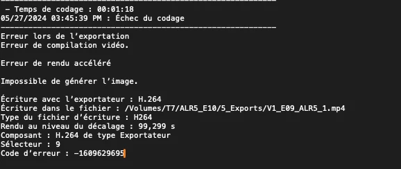

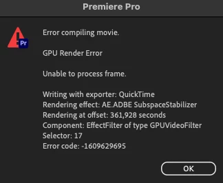

Hi, this is the error I constantly get since last week, I hope someone can help me with that!!
  • Issue - Export failure, wrap stabilizer effects seems to be the cause (see picture)
  • Adobe Premiere Pro version number: 24.4.1 (error happend also on the previous version)
  • Operating system - MacOS Sonoma 14.4.1
  • System Info: CPU, GPU, RAM, HD:
    Apple M1 Pro, 10 Cores (8 performance, 2 efficiency)
    RAM : 32Go
    Hard Drive : SSD Samsung T7 2To
  • Video format: .mov (panasonic gh5) and .mp4 (DJI drone) 59.94 and 23.976 fps
  • Workflow details:
    Sequence settings : 29.97 fps
    Interviews and VOs covered with BRoll (that need stabilization) Some parts are from a multicam sequence of 2 cameras (interviews).
  • Steps to reproduce - (Very important!) Export as usual : File/Export/Media, select the settings then hit Export in Premiere or in Media Encoder (I tried different formats/codecs : .h264, .mov, ProPes422HQ, .mp4 and got always the same error)
  • Expected result - Video exported normally
  • Actual result -  Failure in the export, abortion of the process, only a part of the video is in the file exported, until the bug happens I guess
Tried both exporting with hardware encoding (only possible with Media Encoder) and software encoding.
Tried to take off the wrap stabilizer effect but I still get the error and if not, the failure is at another shot stabilized.
The shots that seem to be the problem are in 59,94 fps (not slowed down) and my sequence is 29.97 Dropframe (I have to deliver on that timecode). Would that be part of the problem when I apply the stabilization effects?

Update : Even on Rosetta I constantly get this error. Export crashes on Media Encoder (I use it almost all of the time because I need to keep working during the export. Even when I'm running both Premiere and Media encoder with Rosetta.
It is always 2 to 5 clips stabilized (all analysed before the export process) that make the export crash. I scroll the timeline to go to the timecode mentionned in the error message to find the problematic clip. The last frame is black. So I drag the next clip a little to the left to cover that last frame. I have to re-analyze those 2 clips for stabilization. Then I run the export again. It crashes and I get the error. I scroll the timeline to go to the timecode mentionned in the error message to find another problematic clip. The last frame is black. So I drag the next clip a little to the left to cover that last frame. I have to re-analyze those 2 clips for stabilization. Then I run the export again.
