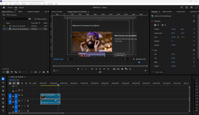

P: Clips disappear on Timeline, Does anyone else have this issue with the new update?
  • October 14, 2024
  • 86 respostas
  • 18149 Visualizações
UPDATE: 11-1-24
We believe that there is a potential fix in beta version 25.2.0 build 3 or higher.  Please update and let us know.  Thank you for your patience and help resolving this issue.
UPDATE: 10-31-24
This is currently a Known Issues we will be providing updates when we know more.  Thank you for your patience.
MEDIA DOES NOT DISPLAY ON THE TIMELINE ON WINDOWS SYSTEMS
On Windows, if a custom scale factor is set in System > Display, media does not display on the Premiere Pro timeline. We are working to fix this issue in an updated version of Premiere Pro. Two workarounds are available:
  1. In Windows, turn off custom scaling and use one of the standard scaling options, or
  2. In Premiere Pro, turn off GPU-accelerated UI rendering in Preferences > General.
Nvidia is up to date and everything else works fine i PP...
Can´t find whats wrong....
Video of the problem.

Hi Adobe community, for the record I can import and edit files in my timeline but they won't display in my timeline unless I highlight them or sometimes when I try to scroll on the timeline. I'm using the latest version of Premier Pro and I updated my drivers.
Has anyone else encountered this?

As you can see on the program monitor, I can look at the video I'm trying to edit but I can't see the clip. It would appear back again and if I shift or do something to it, it will disappear again. I've never had this issue in previous Premiere Pro versions and it's happening after updating it to V25. Does anyone have a solution for this? I've tried deleting my cache, reinstalling the software, changing to different workspaces but nothing seems to work. Thanks.
December 1, 2024
After checking out other's posts, I tried turning off GPU Accelerated UI Rendering in Preferences > General and restarted Premiere and that seems to have fixed it. And I've seen in one post that they'll be fixing this issue in the next update. Thanks everyone and for whoever's facing this same frustruating issue, just turn off the GPU Rendering thing until Adobe fixes it.

When I opened my CC PP to start a project, I have found an odd error I have never seen before.
I imported my video clips into the project.  Then when I went to add them to the sequence/timeline, the yellow bar appeared on the timeline showing that clips had been inserted but I could not see the clips.
I really need to get this video out today and I don't have time to deal with PP bugs today and I DO NOT want to have to create this video tonight on my home PC.
Has anyone ever seen this?  It's definitely a new one to me.
