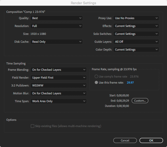

Apr 19, 2021 Apr 19, 2021
Yes, After Effects is better.
Export your 1080p23.976 :30 spots using Apple ProRes422.
Import those into After Effects, adding each one to a separate Composition.   You can do this quickly by enabling "Create Compositon" in the Import dialog box and then choosing "Multiple Compositons" in the New Composition from Selection dialog box.
Add each Comp to the Render Queue and in the Render Settings change the Field Render pop-up menu from Off to Upper Field First and 3:2 Pulldown pop-up menu to WSSWW.  Side note:  Since you're introducing 3:2 pulldown for the 1st time, the cadence setting doesn't matter.  You can save the Render Settings as a template to apply to the other Comps more quickly.  You can also create a custom Output Module that uses Apple ProRes422 to more quickly set that as well.
After Effects Render Queue Render Settings for a 23.976 Comp with Field Render and 3:2 Pulldown enabled.After Effects Render Queue Render Settings for a 23.976 Comp with Field Render and 3:2 Pulldown enabled.
The rendered result is 1080i29.97 :30 with pulldown using Apple ProRes422 that you can be confident about.  It's important to note that you will see blended frames in these renders.  These are not "bad frames" but rather are a result of 3:2 pulldown.
-Warren
