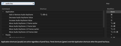

Thanks a lot for the suggstion. In fact, I created a custom shortcut  (see below), but when I do the command nothing happens. I've highlighted the track, placed the playhead where I want the keyframe held down the keys and clicked, but nada. Sorry if I'm sounding too remedial, but just want to make sure I'm not leaving anything out.  Any thoughts?

Ann, I stretched the row height enough so that now I see the Add Keyfram option.  Thanks a lot for your help.
