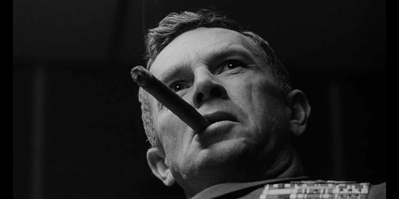

Don't forget... learn from the past...
Sometimes how you shoot stuff makes a difference too.
Dr. Strangelove ( black and white)
combat scenes look like 16mm mopic
https://www.youtube.com/watch?v=h8Mr4jlPJyU
ends around 02:30 then repeats
the above stuff looks like army MOPIC 16mm stuff...very different than rest of movie
low angles, dutched, can make people look large and threatening or powerful.
sample of mopic - This movie link below is very NOT REAL
Obviously. But the movement of camera and film stock is sorta accurate
hand held, usually without sound in combat zones
https://www.imdb.com/title/tt0096744/
A real mopic guy in vietnam with his camera
https://missoulian.com/news/local/vietnam-veterans-voices-haddon-hufford-served-as-combat-cameraman/...
So, by using different shooting methods, angles AND switching between color and black and white, etc. a LOT of influence on your project can be realized. It's not just editing that makes the difference to an audience. It is also planning how to shoot it to begin with.
