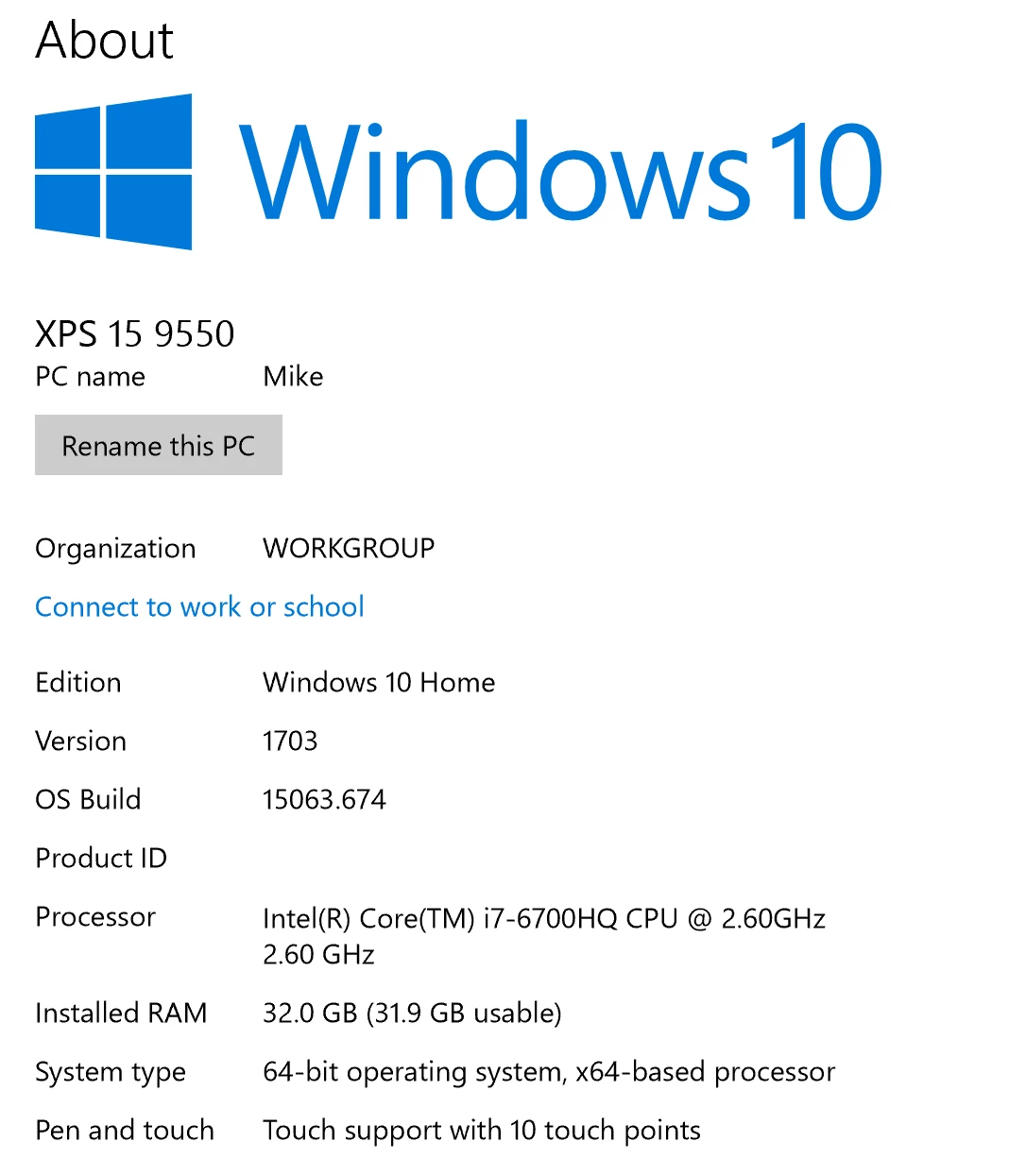

     Been searching the forums, Google, and YouTube to no avail, really. I am working with Premiere Pro CC 2018. The problem was exactly the same on the previous version of Premiere that I updated from about a week ago. Here are the specs of the machine I am working on if it is relevant.I also have a dedicated graphics card, a nVidia Geforce GTX 960M with 2GB VRAM, and all drivers are up to date.

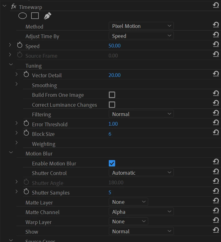

I ended up just jumping into After Effects if I need these types of effects. If you have access to After Effects, then use Pixel Motion blur there, CC Force Blur, or even just the composition motion blur, which are all better options IMO. But if you're stuck using Premiere, know that pixel motion blur uses some component of the "Timewarp" effect, which seems to be working as of November 2018 on Premiere CC 2019. Use that effect (don't forget to put the speed to 100% or where you want it, it seems to default to 50%). Then scroll down to the motion blur part of the effect and check "Enable Motion Blur".
