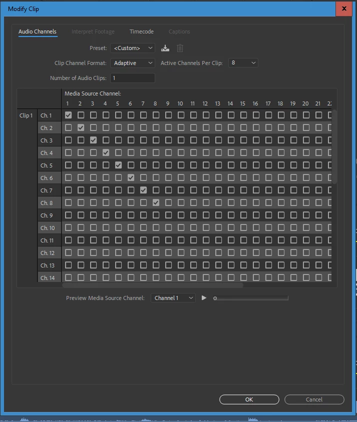

Maybe easier to do by creating a sequence preset. PrPro doesn't allow certain audio things to be done after the sequence is going.
In the Project Panel, New Sequence item, then select a preset for the type of video media you're typically using.
Then in that dialog, go to the Tracks tab, and add audio tracks as needed for your needs. Set the Master to Multichannel. Also ... make sure the Number Of Channels box at the top is the same as the total number of channels you have. That opens up the Output assignment list, so you can post the outputs per channel as you need. Name this and save as a preset.
If you have a sequence already cut you want to change to this, the easiest thing is maybe to set up a pancake-editing workspace with two sequences one above the other ... your already cut sequence above, the new unused sequence below. Select all for the already cut sequence, then drag/drop onto that new sequence. Keep the sequence settings.
You can then right-click on the sequence icon for your new sequence, and get this lovely dialog to customize assignments.
Neil
Neil

I want to my sequence to render discrete audio channels so that I can independently route and control them in playback software.
The key is setting your sequence to multichannel audio BEFORE you start putting things in a sequence. "Number of Audio Channels" will be greyed out until you select multi channel audio.
