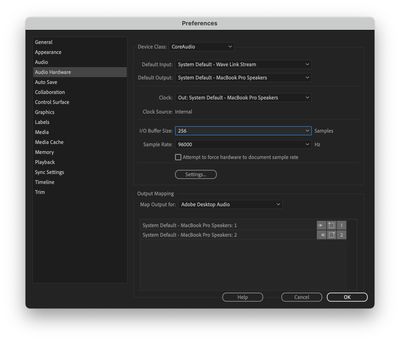

The Audio Hardware system generally want to have a "Full Duplex" device, which has a constant sample rate between the two devices.  When you use Airpods or other bluetooth devices, the output is set to 48k sample rate, but the input device is set to 16k sample rate (Bluetooth has much less bandwidth, so it will use a lower sample rate for the microphone).  This causes issues with Premiere losing track of the audio clock.  If you are not recording audio into Premiere, and switching between audio devices a lot, I highly recommend that you just change to "No Input" to eliminate potential sources of errors.
Another guess, since I do not have one, is that the Wave Link device is being set to a different sample rate than the hardware output and this is causing a clocking issue.  Again, setting "No Input" should help, or creating an aggregate device on Mac OS should also help.  The error message is probably (just a guess though) the Wave Link Software is set to operate at 96k only, and that is why it is forcing Premiere to try and use 96k, when your Output hardware is actually set to 48k.  If there is a setting in the Wave Link software to set the sample rate to 48k, I recommend you do that.

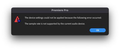

Yes, Wave Link Stream is software to a USB microphone I have (Elgato Wave Link 3), however it isn't plugged into my laptop, in fact, it hasnt been in a long time. When I switched the Input to "no input", the problem got a little bit better. So I went in to change the sample rate and buffer size. The sample rate was already on 48000 when I went in there, but obviosuly wasn't in the screenshot. So I changed the input back to "Wave Link Stream", and I got an error message saying that it wasn't compatible with the current sample rate. I also now don't have the option to go back to 96000. So that must be something with the microphone. I rarely use that mic with my laptop at this point, so maybe that could've caused an issue?
Also, I don't have the option to increase the buffer size to anything higher than 256 (my only options are 16, 32, 64, 128, and 256). This is no watter which input I select.
Another random thing I noticed, which may or may not help, is I get a little caution triangle when I select my AirPods and the Input that states "The Maximum sample rate is too low, choose another device". It doesnt give me an option to increase the sample rate. Not sure what that means, or if it's even relevant, so I'm sorry if it isn't haha. Figured it might be good to share.
I've also attached a screenshot of the error message if that helps at all. Apologies for not trying with the PC, I'm still on the road. I should be home tomorrow to try these same methods on that setup as well.

April 27, 2023
It's happening on my 2021 M1Pro Macbook also, which I'm working on now.
Here are screenshots from the Macbook. I will get screenshots of the PC when I can get back to it.
