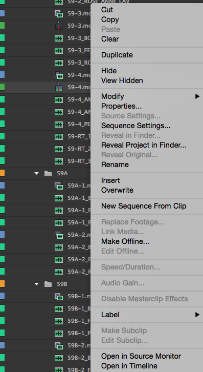

Open the multicam in the timeline view,look at your audio tracks, and see what the problem is.
New Here ,
Feb 20, 2017 Feb 20, 2017
All the audio is there. I want the audio to follow the clip that is selected at the time rather than just playing the one. Is there a way I can have both the video and audio switch between the cameras when I am making a sequence?
