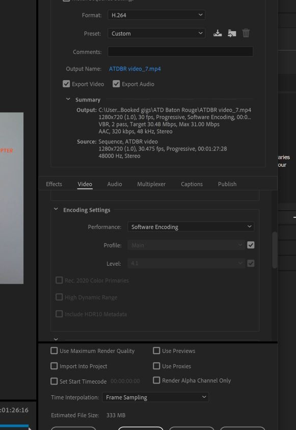

Jan 20, 2021 Jan 20, 2021
How do I download a Radeon Driver?
I've spent hours trying to figure out why my audio and video aren't syncing after exporting in Premiere, and I'm incredibly frustrated. I've tried about 10 different things people in this community have suggested and none seem to work. Any ideas of what might help?
I can see by your sequence and output settings that you have an atypical framerate, which is usually an indication that you are working with variable framerate footage. Audio going out of sync with video is also a symptom of that. I did provide a link in my other comment on this thread to learn more about variable framerate. Here it is again:
https://www.reddit.com/r/VideoEditing/wiki/faq/vfr
Inside the link you'll find other links, including for software to help convert your VFR footage to constant framerate.

Excellent! Glad that did it for you. And in response to your earlier question, yes a webcam would be one of the things that can record in variable framerate. Most commonly it's phones and any software screen capture, so any sort of recording you do on your computer.
