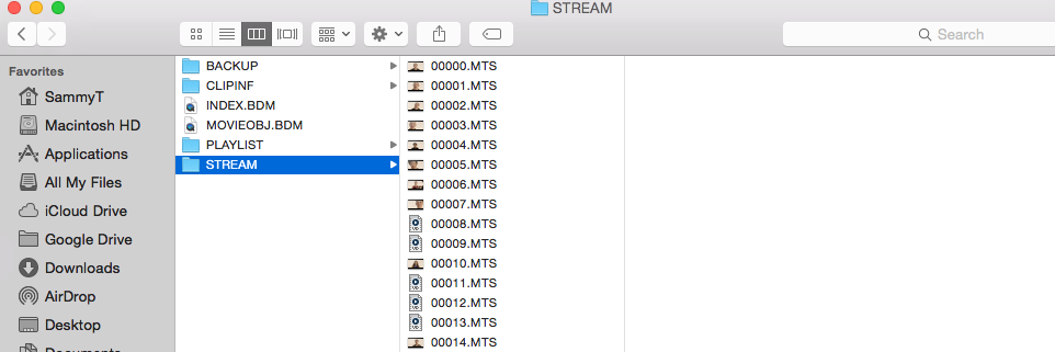

There are a couple ways that I've been using that made it really simple for me to download specific clips without having to export them or unpackage everything I've laid it out how I've done it on my mac.  Now keep in mind it does export the files as a .mts format so if that is not favorable for you then you may want to use the cannon software as well but here are the screen shots of the process I use. I am also using a Macbook Pro 2013 I7
1. Right click on the private folder and click 'Show Package Contents'
2. Right click again on the BDMV and click 'Show Package Contents'
3. This will bring up all the files on the SD card. Goto 'Stream' and download the files that you need.
Hope that was helpful.
