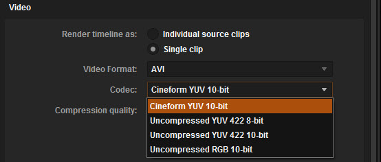

Community Beginner ,
Aug 04, 2015 Aug 04, 2015
Rob,
The problem we were discussing in this thread was using the FRAPS codec inside an AVI container. If you are exporting an AVI from DaVinci Resolve, then you will need to know which codec is being used to compress the video inside your AVI container. By default Resolve will export using the Cineform codec inside an AVI container. In that case, you will need to install a Cineform reader on your system in order to import the AVI into other programs that don't natively support Cineform.
You can download the Cineform decoder here: Cineform « Neo Player Download
When exporting an AVI from Resolve, you can select the codec to use from this menu:
