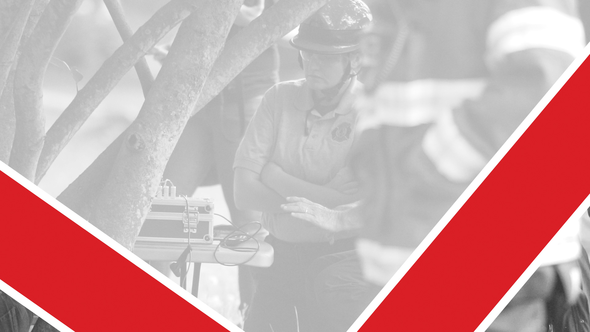

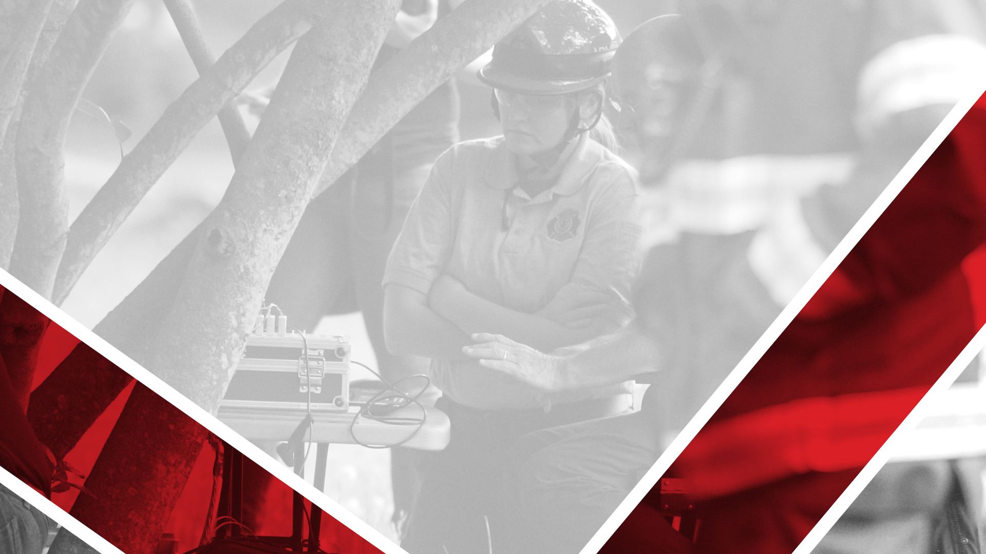

I'm building a sequence with 5 video channels which is essential a mask I built that will overlay a video. When testing in the sequence, the red area has a Multiply blend but when I nest this sequence into my main sequence, the blending mode is gone. Is there any way to fix this? My only fix is to keep the video inside the nested sequence but I don't want to do that.
Example 1- Sequence before nesting
Example 2- When nested

Strange.  Some kind of alpha issue maybe but it seems like the blend is not "transferring" across to the nested sequence..
If you un flatten it in the nest sequence...can you reapply your blend?
Just wondering how you made the red mask with the white  key line border.  Titler, psd,png, ai,..?
Can you try a different way of making it as a test.

Thanks for responding. I'm not sure how to un-flattten? If I un-flatten won't that expose all my video layers? I'm nesting all this so I'm not transitioning a boat load of layers.
I made everything in Photoshop. All three are separate PNG files. Red mask, white border and the center mask.
