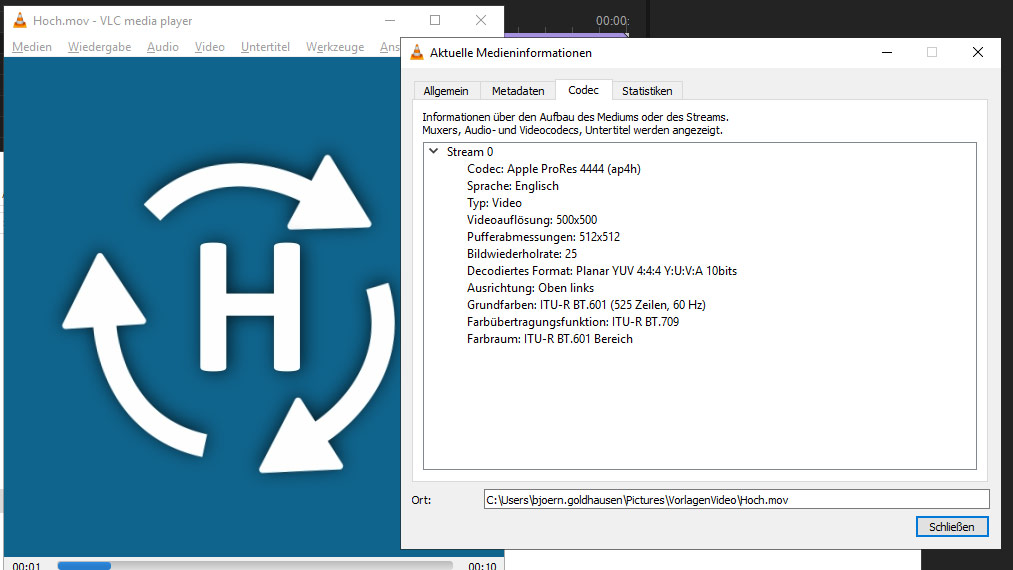

Where are you exporting them from? Could you share a screenshot of your original MOV export settings?
Community Beginner ,
May 13, 2019 May 13, 2019
Contributor ,
I don't think that's quite what I'm looking for, but your screenshot gave me a hint as to what might be your issue.
It looks like there's a slight shadow around the white portion of the video; I imagine that's affecting how the background keys out within premiere since those shadowy pixels will be a lower value (darker) than the rest of the blue being keyed out.
Where did you originally get this clip? Did you create it yourself? Is it downloaded from the internet? Is it from a friend or colleague? I ask because if you can access the project files of the original composition, you could delete that shadow and the background should export and key out cleanly.
