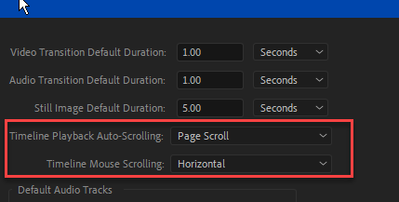

Hmmm... I just tried something and it seems to works well. I can scroll with my scrollpoint up/down over the program monitor and it jumps like we've said. However, if I scroll sideways over either PM or timeline it will scrub either way without jumping clips. It goes to a moderatly fast scrub. So you might want to see if that works for you. I played with the Timeline mouse preferences also, but it didn't change the above. I think these are the default settings buy you might want to check them.

Hwo did you get to that dialog screen?
Feb 01, 2025 Feb 01, 2025
That's Preferences/Timeline.
I've left mine on Vertical since that post, and I'm liking it more and more. 🙂
