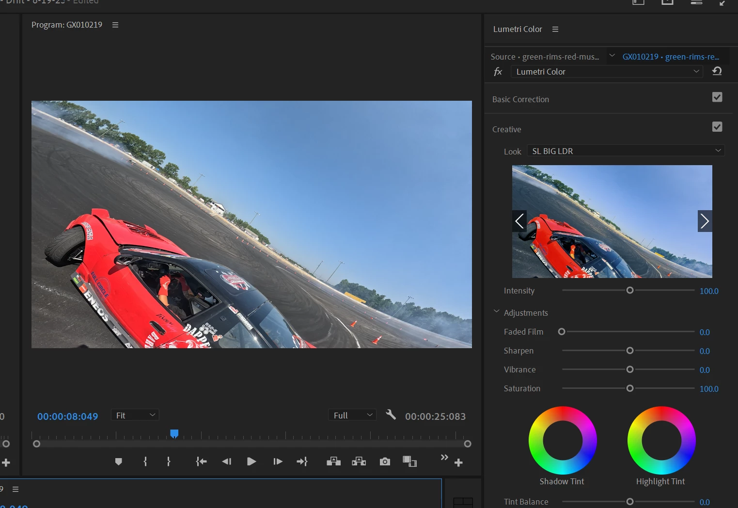

I cant figure out how to view a color effect in my main window when editing.  Very new to Premiere so I dont know if its me or the program.
Basically I add a piece of video to my timeline, go to the right side pane and select lumetri color and then creative.  When I select an option from the dropdown list it shows in the small window in that same pane, but my main viewing window does nothing.
What am I missing?
Correct answer marchvet96
Update:  So while talking to a friend he asked if I had the global FX muted.  I didnt know what that was and never used it(see my screenshot that shows the FX button isnt there).  After I added the button and turned it off, its working now.
Why would that be turned on?  I have reinstalled premiere a million times, reset the workspace etc and it only was fixed because I added that FX button and turned it off.

marchvet96AuthorCorrect answer
August 23, 2023

August 23, 2023
I was trying to add effects to the timeline only.  I either had a bug or something in Premiere but the FX button was never used by me since I first started with it a few months ago.
I tried a million different things over the past few months and was just about ready to delete Premiere and cancel.  Still weird that the FX button or whatever global function was turned on even with clean installs etc.
