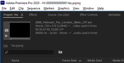

Premiere Pro do sometimes interpret footage incorrect and when that happens or when the end use use a non-matching timeline those things may happen. Make sure that the clip is 720x576 (1.0940) and make sure to edit in a timeline that is DV PAL Standard.
Since the clip is interlaced, make sure to know if the clip is either Lower Field First (LFF) or Upper Field First (UFF). Placing a UFF clip on a timeline that is LFF will give you interlace artifacts. If unsure about the field dominance, open the clip in After Effects to check it. After Effects reads the correct filed dominance almost always while in Premiere Pro it is more of a lottery.
In Premiere Pro i make sure to enable the Preview for a more detailed info about the clip. (See the attached image)
