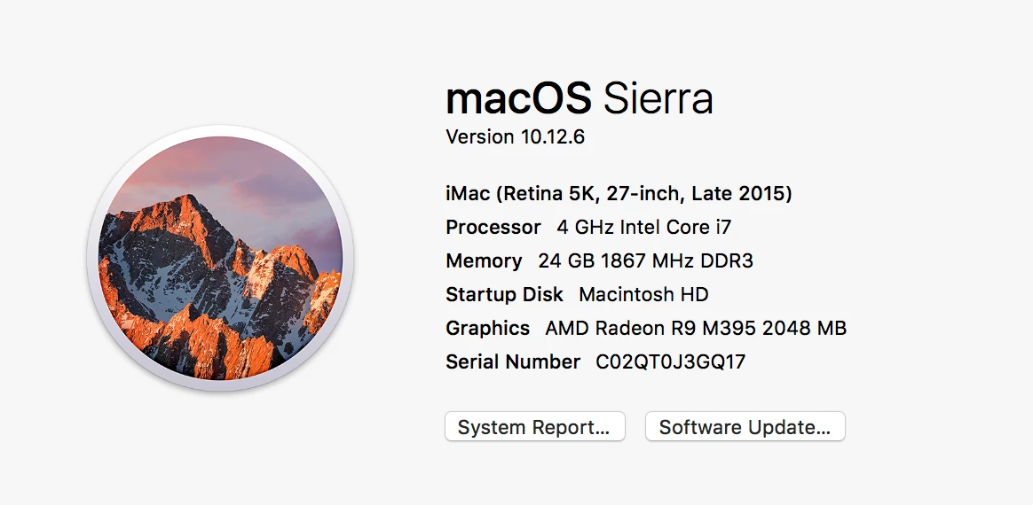

Hi all.
I was so excited...my first attempt at CAPTURING a TAPE using PremiereCC!
But, Premiere disappointed. I'm using a Sony HVR-Z1U, attempting to capture a 1080i60 HDV tape.
I set up the project, selecting HDV as my capture type. I got the Capture window open, and have machine control.  But that's where it gets, uh, funky.
I can control the camcorder...but the capture window is black. I get an unspecified video error when I attempt to capture in HDV.
When I change the capture mode to "DV", lo and behold, I can see video in the window. A short test capture confirmed my suspicions...that yes, indeed, Premiere wanted to capture my 1080i60 video as DV25.
I know the tape is 1080i60...and so does my FCP 6/OS 10.4 system (the "analogue suite" in the basement), where it's happily capturing an HDV file...while my Premiere system sits, like a dead Ferrari, looking oh-so-pretty...and pretty useless for the task at hand.
Anyone want to take a gander at what gives?
