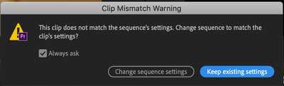

2) Drag one of your clips (that is of a standard size) into Premiere it should pop up with the following window:
3) Select 'Change Sequence Settings' and the sequence will then perfectly match your clip. If you've been working away on the other project then you can copy and paste them in, which will paste them in at the correct resolution.
