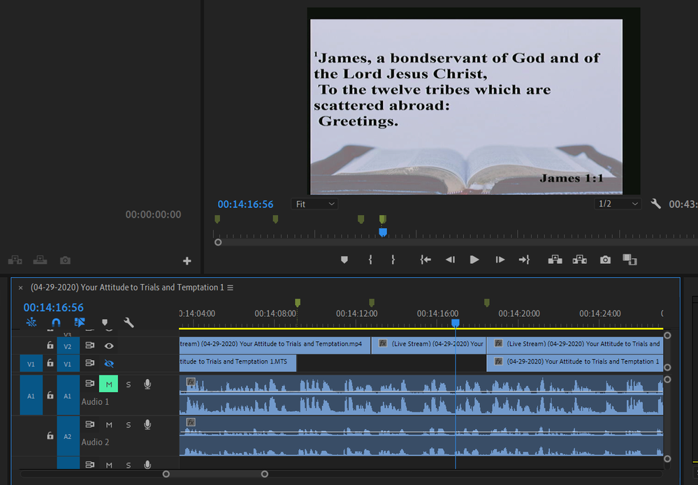

Hello, I have two full sets of clips in same sequence. Both have their own video an audio source. I am trying to take clips from video source 2 and insert them into video source 1. This requires that I stretch the clip taken from source 2, in order for it to match the space in source 1. But any time I stretch the clip from source 2, it also fills in the previous time before or after the cut based on the which way I stretch it. I only want the clip I cut out of source 2, and then I want to be able to stretch the clip to fill the space in source 1. Has anyone ever had this issue, and if so; what was your solution. I appreciate the help in advance.

clip cut between last 2 markers  S2. Clip is the same between the last 2 markersclip cut between last 2 markers S2. Clip is the same between the last 2 markersexpand imagesame clip stretched to fill space on S1. When stretched, clip also displays S2 before the makers where it was originally cut from.same clip stretched to fill space on S1. When stretched, clip also displays S2 before the makers where it was originally cut from.expand image
When I stretch the clip from S2 I only want it to display what was between the last 2 markers.

You are not stretching the clip but extending (there is a difference).
Stretching means changing the speed of the clip as in slowing it down.
Extending means increasing the duration.
You dont need to extend just drop it in V1.
The part under the first two markers wont show anyway.

Ok. But if I just drop the clip in from V2 into the space in V1 and I do not extend it, then I will end up with a gap in my video. I am trying to get rid of the gap in V1, while only displaying what was clipped from V2. V1 is the video that I will export in the end.

When it comes to the audios, I will keep A2. But my issue is when extending the video from V2 in V1. I want to make sure that there are no gaps, but only display what has been clipped. So when I extend the clip from V2, I do not want to display the video before the cut. Just the video within the cut, while eliminating the gap in V1.

Cut and ripple delete will get rid of any gap.
