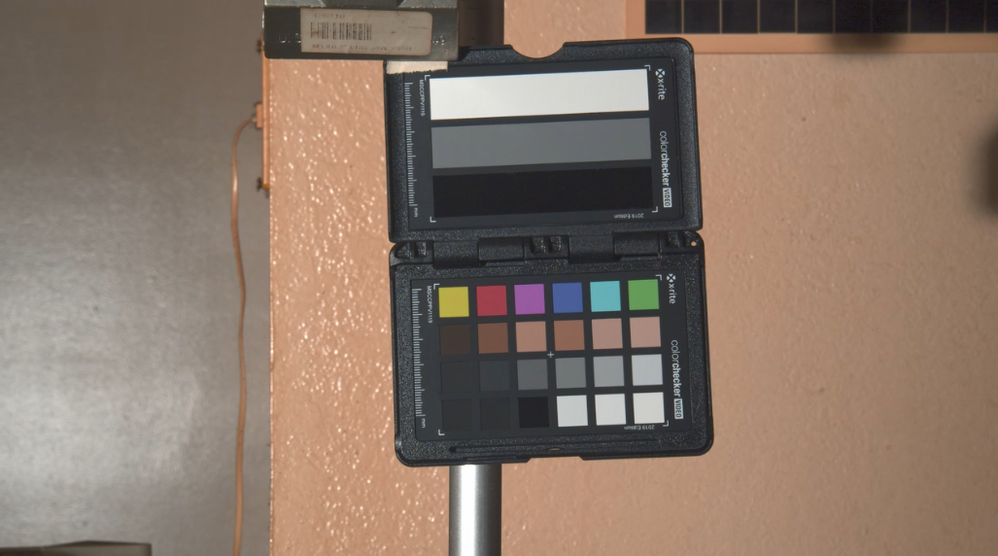

got the chart late yesterday, shot it, stuck it in resolve, used the x rite color mask on it, and it came out really good with the auto 'match' feature. Then messed around with back wall a little cause it's ugly ( desaturated it a hair ). I'm happy with it.
Copy link to clipboard
Copied
In Premiere, they don't have an auto-recognize feature, however as I noted ... just make a rectangular mask around the chart, then hit the 'auto' button in the Basic tab, and it does a pretty decent job of getting to 'neutral'.
Neil
Copied
Thanks Neil, you are a really good teacher.
You know way more than me about color stuff and scopes and so on... so I hope I continue to learn from you.
I'm curious... you say you made mask around chart and did auto color in basic tab... but I have questions.
I used a Lowel DP light ( tungsten ), 1k watt, 32k color temp.. and shot it with bmpcc braw 4k.
Then used the mask thing here and it came out pretty good.
If I was shooting on a stage and wanted to give post a good 'chart' for basic correction ( collaboration) I'd use only the color temp light that matched my camera settting. That way, if I add half CTO to a light coming into a set window ( to simulate sunset ) the basic color correction gives me the look I wanted when I shot it ( and put that color correction gel on that light ).
In other words, when shooting the chart you may want to shoot it using ONLY the color temp light that matches the camera white balance.
Did you by any chance have control over any of that ? What light did you use to shoot the chart ?
Can you put a sample of that shot of the chart up here so we can both see the similarity ???
That would help many people are using Adobe PPro and trying to 'match colors' etc... don't you think ?
