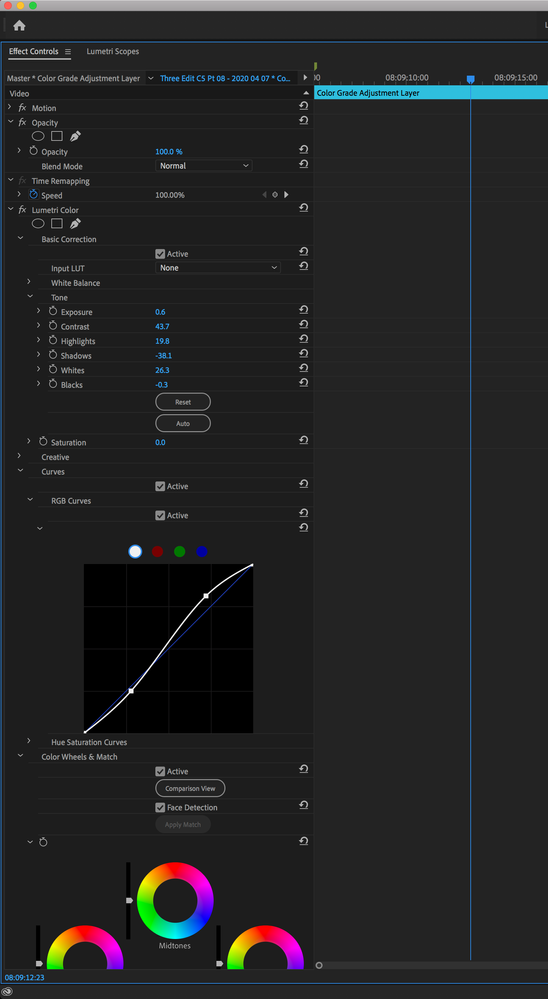

I may be wrong, but, in the case of Lumetri Color, it may be more complex to keyframe in that way. This is because (at least as far as I can see) in Premiere, many (though not all) of the individual settings within the Lumetri Color effect panel can be keyframed, like Exposure; Shadows; Saturation and the Color Wheels. But, apparently, the individual Lumetri Color components cannot be keyframed together as a complete set.

LEGEND ,
Jan 18, 2021 Jan 18, 2021
Add an Adjustment Layer over the clip, and apply Lumetri on that. In that Lumetri instance, grade to the total change you want to apply.
In the Effects Control Panel (ECP), use the Opacity "intrinsic" effect to animate (keyframe) the effect of that Lumetri instance on the total image.
