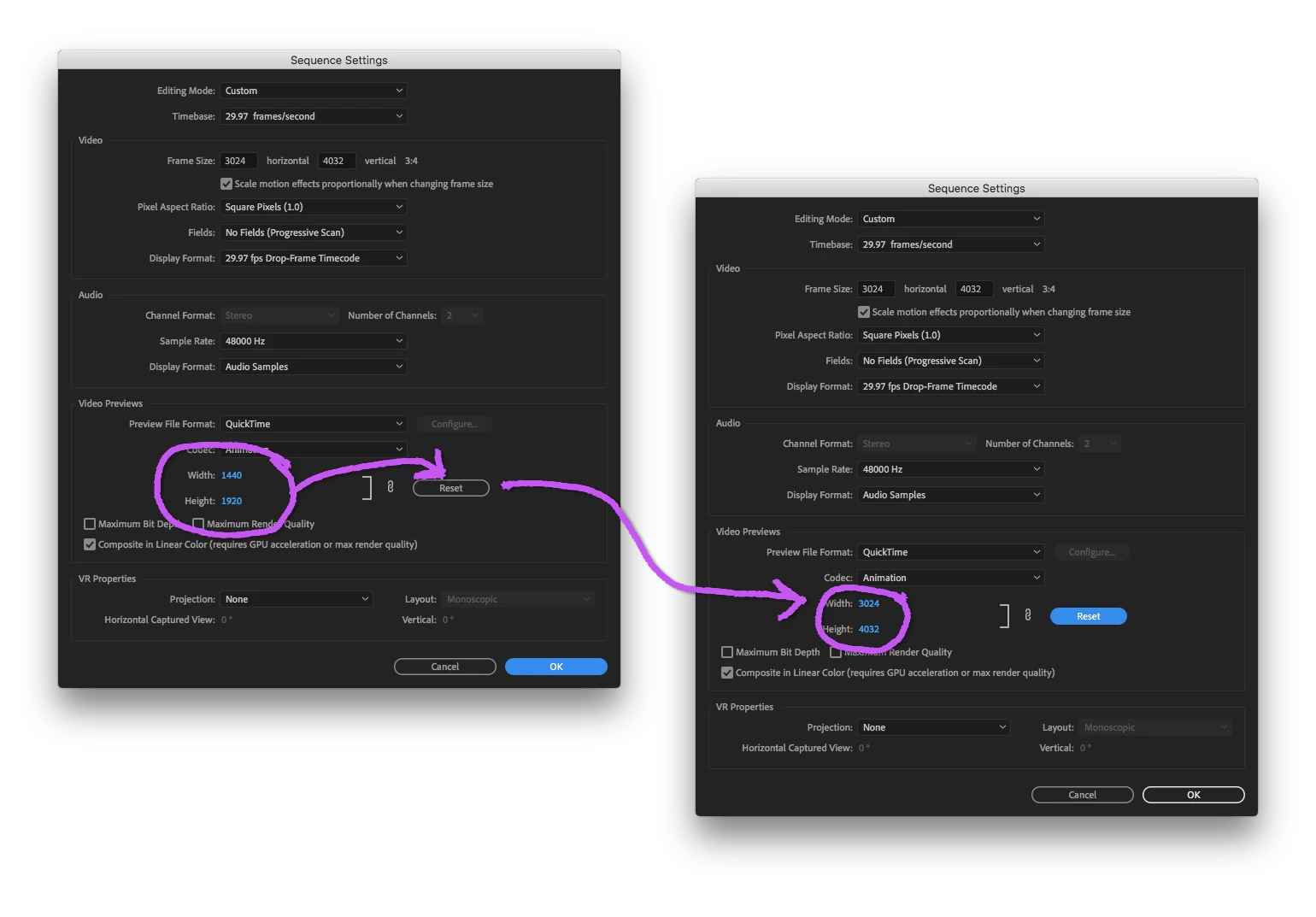

    Matthew:
    I initially suspected it was a bit rate issue (or some other settings issue), but I tried re-creating what you're doing with some photos I took of plants over the weekend and came across something that might be causing your loss of picture quality when you export at 100% rather than 50%.
    Go to your Sequence and double-check what the Video Previews setting is for Width and Height.  If it's 1440x1920, then that is the likely cause.
    Here's what I did:
    1. Take photos at 3024x4032.
    2. Import photos in to Premiere Pro.
    3. Select all of the photos in the Project panel and drag and drop them onto the New Item icon to create a Sequence at settings as close to the still images as possible.
    4. Chose Sequence > Sequence Settings to check the Custom settings.
    5. Under Sequence > Sequence Settings > Video Previews clicked "Reset" to change 1440x1920 to 3024x4032.
    6. Add fade in at head, fade out at tail and transitions along with a push in on each image.
    7. Chose File > Export > Media..., setting the Format to H264 and the Preset to Match Source - High Bit rate.
    The rendered movie looks great as an H264 mp4 with a target bit rate of 10mbps and maximum of 12mbps at 3024x4032.
    It seems with this workflow Premiere Pro automatically sets the Video Preview to half the width and half the height which would cause previews to render faster, but it commits you to either changing it later or being sure not to use the rendered Video Previews on export.
    -Warren
