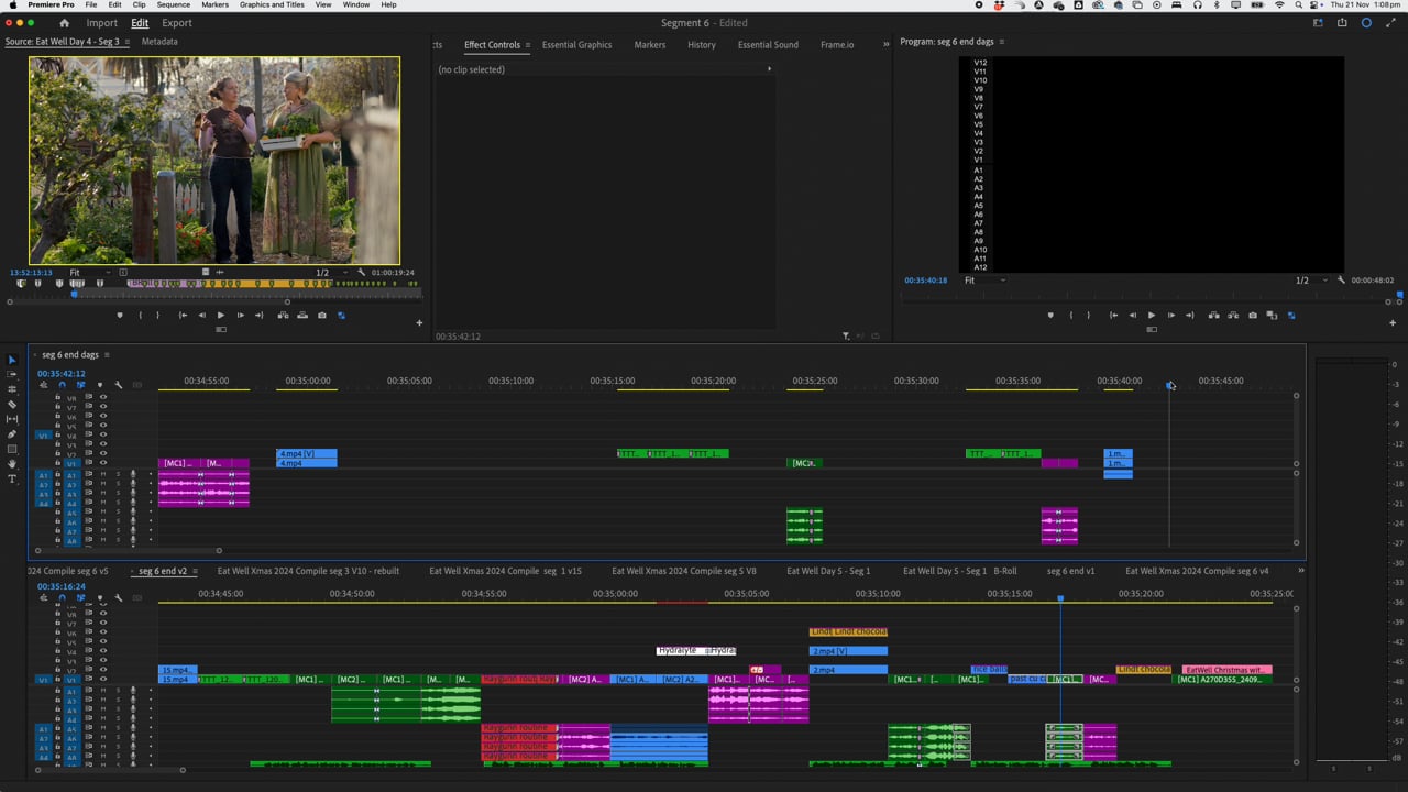

I've noticed a horrifying (for me) bug: when I drag & drop (or copy & paste) edit sequences into a compile sequence, my multicam shots are being swapped over at random.
This compile editing is all being done with the "insert and overwrite sequences as nests or individual clips" switch on my edit timeline set to bringing in sequences as individual clips. When I edit in each of these stories as a nested sequence, the multicamera shots don't change (and there are only two camera angles on the multicamera shots)
The solution is to edit these source sequences from my source monitor into my program monitor (and the multicams are staying selected as they should be); but I don 't understand why drag & drop from my project window, or copy & paste from other timelines is causing my multicams to randomly swap multicam sources, but fortunately I can edit from a sequence in my source monitor into another sequence in my program monitor, and the multicam clips aren't swapping.
I'm compiling stories into segments in a productions project, I'm not sure if that's a factor (each story is created in it's own project, and then copied into the segment project)
Is there a basic premise of editing here in Premiere Pro that I've missed? MacBook Pro (16-inch, 2021)

Unfortunately I posted too soon; deleting & replacing  my user settings temporarily stopped the issue, but all of the issues have returned, inconsistently.  Sometimes the issues. (Can't edit/ video output sawpping etc) don't occur, then randomly they do. I even have a scary new issue: my multi am clips are displaying wrong source time code.  I'm trying to limp through to the finishing line on my current project, relying on my work arounds (importing edit sequences between projects & clearing out my source monitor when grading), then I'll have to seriously review what's causing these issues.

Thanks @jamieclarke  WE HAVE A WINNER!!!!!  (sorry for shouting! 😉 but I've had several weeks of severe pain with this - to the point where I was contemplating moving systems!!!).  I've started to use Premiere Pro with a completely refreshed / rebuilt user preferences folder (the 24.0 folder), and I've removed all the previous user preference folders, so far - very good!
I'll have to keep testing this solution - but already I can do the exact kind of edit (sequence from one project in my source monitor into a sequence from another project in  my program monitor).  I've done a few test edits - and they've all worked as they should; I'll keep editing during the day & let you know how it goes.
This has also fixed another issue that I was having - when I adjusted a colour effect in the Lumetri panel (on a clip in my program timeline seqeunce), the video output (and video scopes) kept reverting back to the source monitor output - this is now fixed too!  Double points for you @jamieclarke

Hi @Andrew C. Brinsmead - Thank you for the screen recording, that is strange.  Can you try one thing for me first backup your settings folder (24.0) and then go to Documents > Adobe > Premiere Pro > and delete the 24.0 folder.  Then launch Premiere Pro and let us know if that helps your issue.
