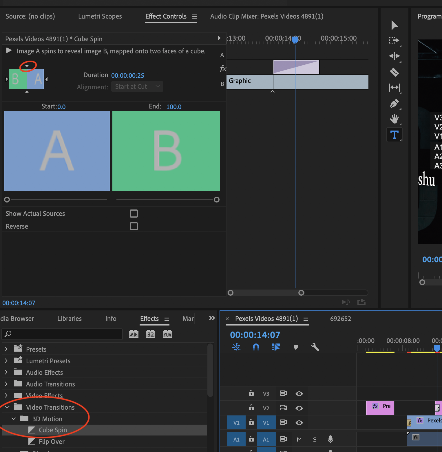

I am not sure whether it will work as per your requirement but you can try out the Video Transition. Effects panel > 3D motion > Cube Spin > Apply it as the start of a text clip or end of it...then select the transition & in the effects control...choose top.

uhm very interesting indeed. That could be a solution.
I try and tell you about it;)

Nothing to do: the effect does not give what I wanted to recreate because I wanted the text and then the movement to start from a specific point.
I'm afraid it can only be done with AE.
