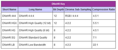

I was just looking at an Avid doc that stated DNxHR 444 is RGB, unlike the HQX which is YUV. Here's a chart from Avid ... showing RGB  Chroma Subsampling for DNxHR 444:
I've just been through several forums from Lowepost to Reddit and Avid ... the accepted tale is that DNxHR 444, as an equal 4:4:4 codec, is full RGB, unlike the rest of the DNxHR codecs, all 4:2:2, and which are YUV.
So I'm fairly comfortable with saying Avid apparently considers this an RGB codec.
