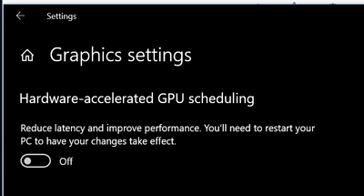

There is also one other setting you can try related to video performance buried in windows 10 thats a new thing.  Windows at some point last fall, added Hardware GPU Schedule in the Settings for Graphics cards (Display Settings, then graphics settings).  The screen shot is below for the menu.  This by default is OFF.  But try turnign it on (on a very small set of apps will run slow with it on, youtube has some benchmarks if you want to know more on this).  One pro tip here, is the note that says you have to restart windows really means restart windows, it doesnt work with a power off then on as it keeps the setting until a true restart is issued. Use the restart in the shut down window.  Let me know your thoughts, I hope there is something new here that can assist you.  Sorry about your troubles, they are very strange.

When you mentioned the GPU scheduling, I really thought that might be it-- I remembered I had to enable it because of some other software somewhat recently, but it doesn't look like that's the case.

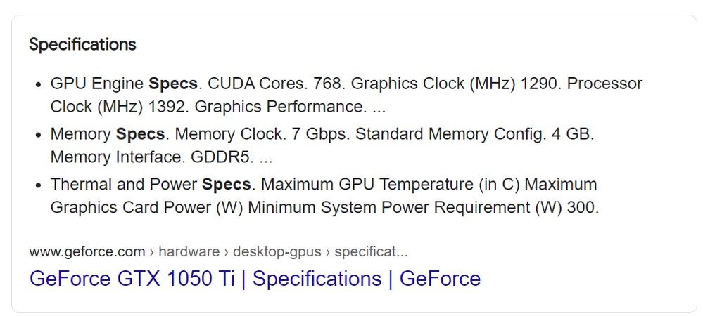

My quick read of the thread, it seemed to have some good ideas in there.  The one that struck me as relevent was the size of the video memory on the graphics card.  But there was a few other gems in there.  I had to look the specs up (pasted below) and that card only has 4GB of memory.  I was a little surpised as I didnt think they made cards with less than 8GB.  If the video memory turns out to be the issue its goign to very hard to fix on a laptop (maybe an external eGPU, but if you have to do that I would buy a new laptop).
This thread I shared, also went into "smart render" as a workaround if memory serves me correct, I read so many now I may be wrong on that.
If you load that on another machine you have, it woudl really shed some light on the problem.  I would suggest that you try and use a machien with 8GB of memory.  I read somewhere that each 4k video frame needed 4GB of memory.....
https://www.notebookcheck.net/NVIDIA-GeForce-GTX-1050-Ti-Notebook.168400.0.html
