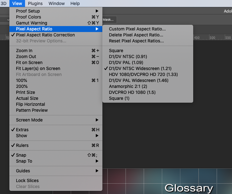

but you can set up your image files in photoshop to display correctly.  this is a 720x480 file widescreen dv menu for a dvd.  you'd need to resize it to 854x480 for it to display properly on a computer screen, but you can set photoshop up in the view menu to display properly within photoshop.  Screen Shot 2022-09-27 at 5.57.46 PM.pngScreen Shot 2022-09-27 at 5.57.58 PM.png
