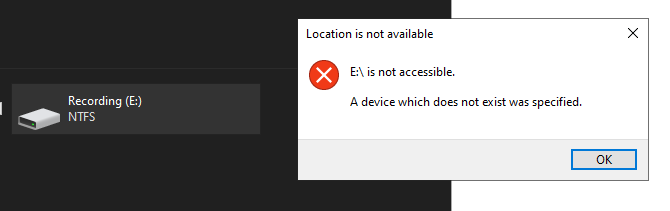

EDIT: I forgot to mention that once the recorded file can't open anymore, my entire drive becomes "unrecognizable", meaning I have to restart for it to start working again. I managed to get another drive and it suprisingly only happens on the NVMe drives. Works just fine on a normal SATA SSD. I guess Premiere hates Gen4 NVMe speeds? Very odd.

UPDATE: So unfortunately, none of the given tips have worked. It still wants to temporary "corrupt" my drive. I'm going to attach files of what the error is and what happens to my drive when exporting.

SOLUTION: WOOHOO! I figured out the issue that I have been having! Interestingly, this problem that seemed to be a nonissue is actually a bigger problem!
See, I had 32GB RAM previously and I wanted to get double that while also still being dual channel. However, the same problem persisted (because I thought I just didn't have enough for Premiere). It very oddly turns out that the motherboard is not providing the features it needs to support the hardware to its' full potential.
With that said, I loaded optimized defaults (ASUS Motherboard) to make everything not overclocked and back to normal, overclocked each component one by one, and walla (not really)! D.O.C.P, in other words overclocking RAM. I can't even run 3600MHz on the sticks I paid for, so I will 100% return these and get my money back.
This is great because I can get 3200MHz sticks up to 128GB! I know what you might be thinking though: "Why are you exchanging the RAM when that is not the main problem?" That's a good thought to ask and I'll explain. New CPUs are going to arrive sometime this year in the later months and it would not be reasonable to buy an entire platform of the same when that does occur. You could say that for RAM too since DDR5 is releasing, but well... you got me on that one.
