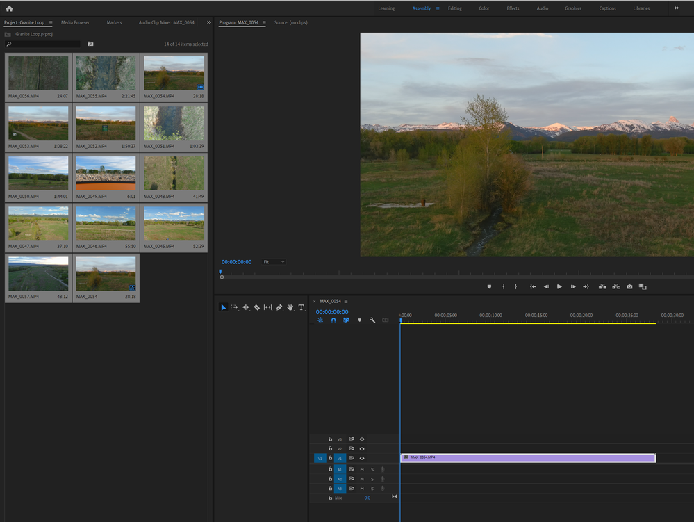

Here is my new project with the first file in timeline to set the settings. I checked and everything is as it should be. It was at this point in the last project that I just selected all source vids, right click-create proxies, then just dragged from this same folder to start editing, then I ended up in that mess.
May 29, 2021 May 29, 2021
I think you are good to go. Just create the proxies and you should be fine. Drop in a clip or two, make them short and export to see what you have. Don't set any export options.
