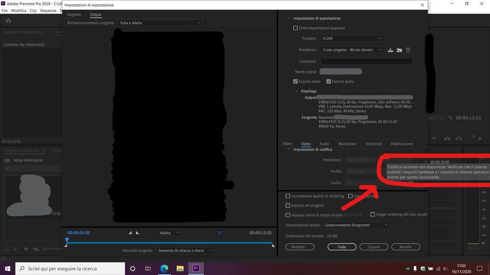

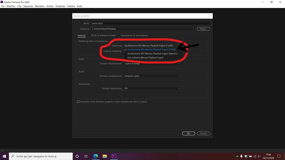

Hi, I have a laptop with an i7 8750H, 16GB RAM, Intel(R) UHD Graphics 630, and a dedicated GPU NVIDIA GeForce GTX 1050.
My problem is that when I open a new project I activate the acceleration CUDA from the project settings but when I export the "hardware acceleration" setting is not clickable to change from "only software" to "hardware", and if I move the cursor over it there is written, "hardware acceleration not available". I think I have all the requirements software and hardware.
How can I resolve it?
Thanks.
I attached screenshots. (censored for the privacy of the people those are present in the video that I insert in the project to try).

Ok guys I have resolved the trouble, i had to download the latest update version of premiere and now hardware acceleration works. it's surprisingly speed !!!

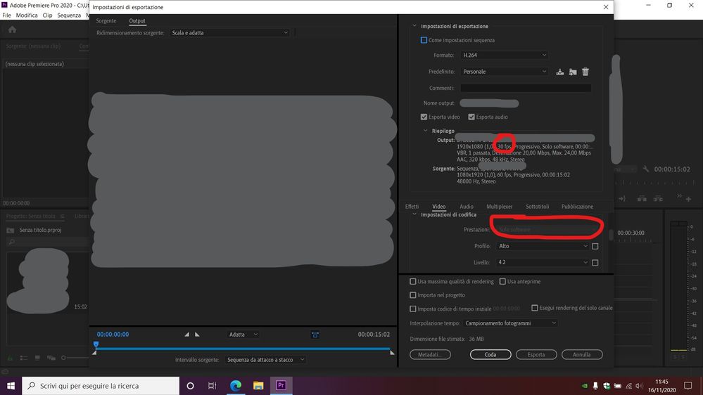

Maybe because it's 60fps. Can you try changing the frame rate and check if it becomes available?
Explorer ,
Nov 16, 2020 Nov 16, 2020

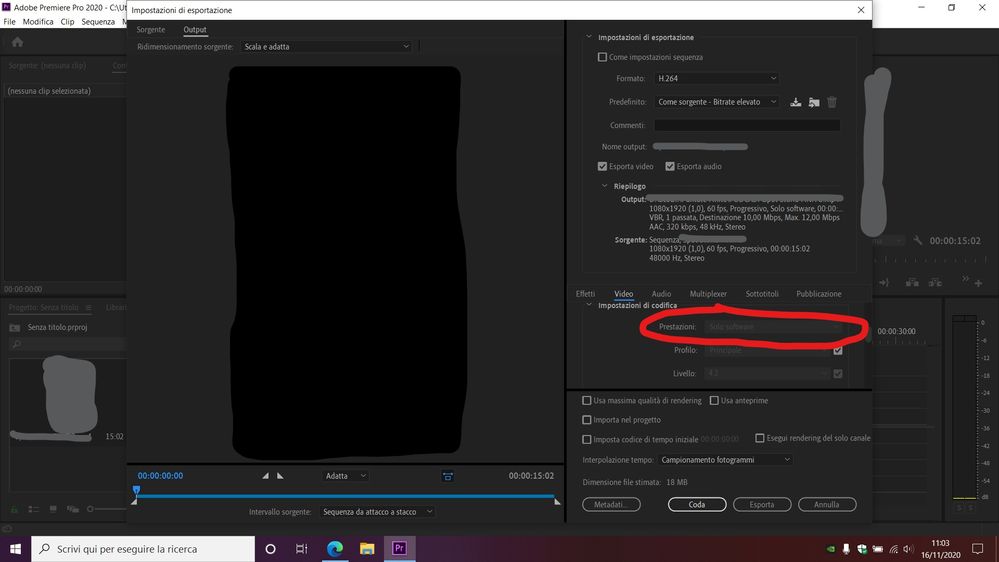

Ok I'm trying to replicate your issue. The only things that prevent me from using hardware encoding are the Profile and Level (Profilo and Livello). Can you try lowering those and see if it helps?
Explorer ,
I tried lowering those parameters but nothing has changed... the tab "performance" is not clickable and it is stuck on "only software"
