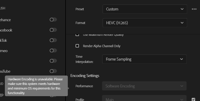

So what could be the problem? I noticed that hardware encoding is greyed out:

"Hardware Encoding" for H.264/5 codecs often requires an Intel CPU that has the hardware inside it, now referred to as an iGPU .... and the Ryzen chips don't. Not even all Intel chips have one ... any Intel chip with F in the chip name doesn't.
I think (though I could be wrong here!) that the 40 series Nvidia cards were the first that could really do H.264 encodes on the GPU, but then ... that kinda drops GPU use for the effects processing, from comments I've seen.
So your system might not have usable hardware encoding for long-GOP codecs.
LEGEND ,
Aug 29, 2025 Aug 29, 2025
I don't think your CPU has an iGPU ... very few Ryzen chips do, and those only very recently. So the CPU cannot do "hardware" encoding of H.264/5 long-GOP media.
The GPU might, but then, that's going to be done on top of all other effects work sent to the GPU ... and the system is going to be swapping things to/from RAM like crazy.
