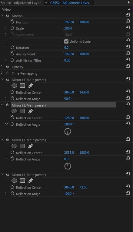

Explorer ,
Jul 07, 2022 Jul 07, 2022
Effects 1.jpgexpand image
iEffects 2.jpgexpand image
Explorer ,
Thank you for getting back to me, mirror effect is on both bottom adjustment layers, and the actual transition effect is on the top adjustment layer. This is happening with multiple different transition presets as well! I attatched the pictures below...

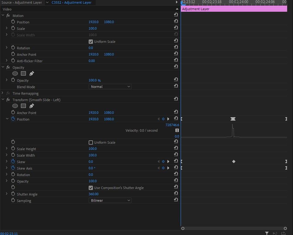

Effects 2 With Replicate.jpgexpand imagemain preset effects.jpgexpand image
Advocate ,
That's really odd.. I can try sending a video to re-create it from scratch to see if that works, if you'd like. I think the best thing to do is remake the whole preset.
I noticed that the curved you have on the position keyframes is weird. Click the keyframes, right click, click "Temporal Interpolation" and click easy out or easy in, on all the keyframes. Or essentially just remake the curve.
Lastly, you said this only happened in 22.5? Then try reverting to 22.4 and test to see if it happens there.

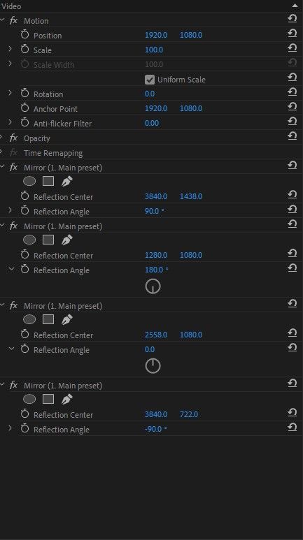

You were right about the scale being set to 300, I changed it to 100 and re-applied the Replicate effect and this is what I'm coming out with... attatching sg of my effects panel with replicate effect turned on and also a sg of the main preset effects panel..
