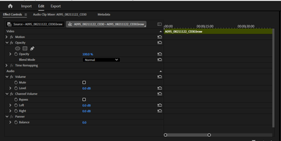

Help! Bring back Motion!
Contributor ,
Oct 28, 2025 Oct 28, 2025
Help! Bring back Motion! Properties are not working either

Weird ... with a clip selected with the 25.x run, this is my ECP.

I encountered this problem on Reddit. There is no solution. Creating a new project and transferring files there does not help; developers need to understand the cause. The problem persists in the new beta! This is a terrible problem

I've seen that with sequences imported from XMLs (Resolve, etc).  Apparently its a known issue that will be fixed in the next release.
One workaround is to export the sequence that has clips without motion properties as an XML and then immediately import the XML.  The clips in the new sequence created from the XML you just exported will have their motion property controls restored.
