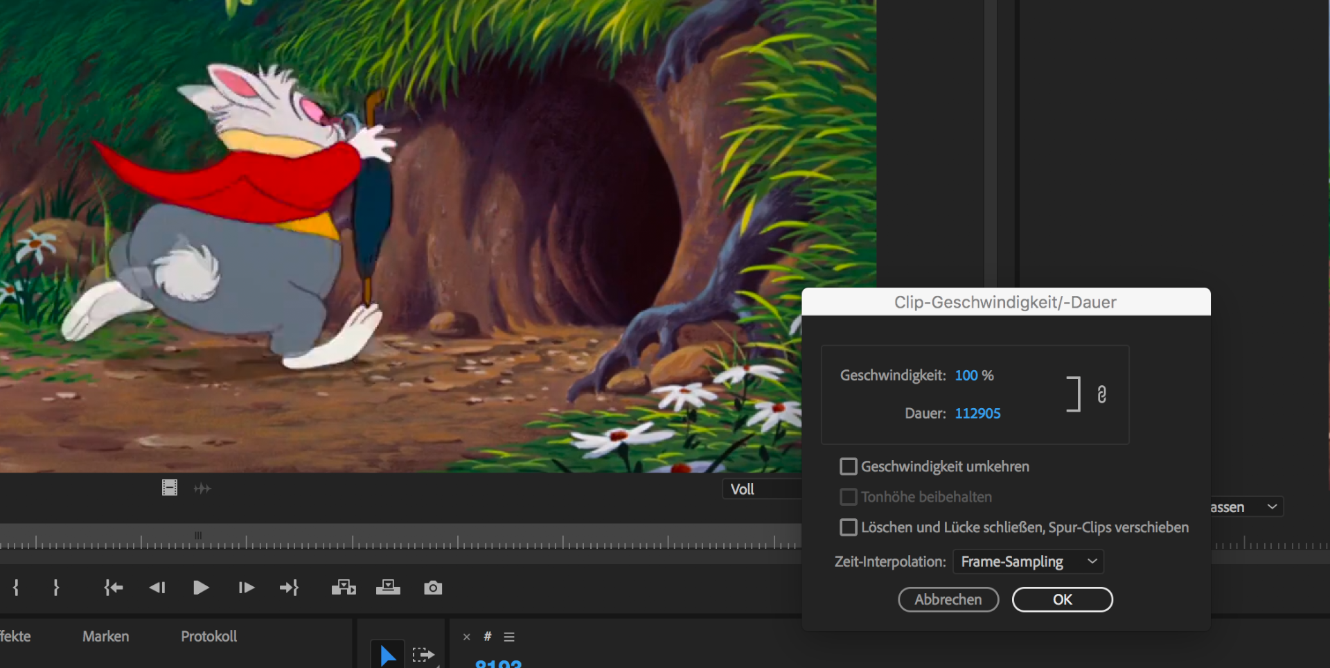

Apr 23, 2018 Apr 23, 2018
If you have retimed footage Premiere Pro will apply frame blending to try to interpolate using either a frame mix or optical flow. If you don’t want this to happen it can be switched off so you only have the original frames repeated. To do this, right-click on the clip and choose Speed/ Duration. In here you can switch off frame blending. Hope this helps.

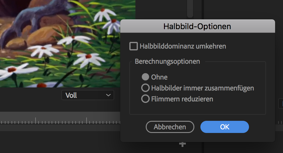

I turned all the frame blending off. My settings look like this now.Bildschirmfoto 2018-04-25 um 14.43.03.pngBildschirmfoto 2018-04-25 um 14.43.21.pngBildschirmfoto 2018-04-25 um 14.43.32.png
   The effect is still there. Could it be that my source file is a recording of a bluray that was recorded with
   frame blending on. So now the artifacts are in the file, not effectable anymore?
