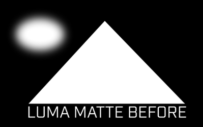

You can also use light and dark to help you key, usually called a luma matte. If your object was dark and you used a white background (or vice versa) you could create a matte to separate your object.

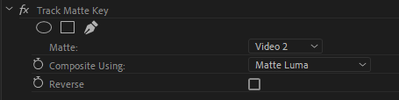

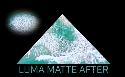

At any rate, if you do have a clean key you can potentially turn that layer into an alpha or luma matte. I'm not sure if Premiere will recognize an alpha matte based on Ultra Key, but you may be able to create a luma matte. If you play around with Levels and a Tint effect you should be able to crush the scene into two values: black and white. In this instance, if your key is clean, you'd actually want everything to be white, because what would be black is what's keyed out already. Then you can use the Trackmatte Key on a version of the original clip (with no ultra key or VFX), direct it to source from the layer with your Key/Tint/Levels (this layer is traditionally above the original-coming from working in AE-I'm not sure if it makes a difference in Premiere), and set it to luma.
Now you're not really using Ultra Key to punch out the background, but using a Track Matte. The Ultra Key was just helpful for creating the Track Matte (if this works out).

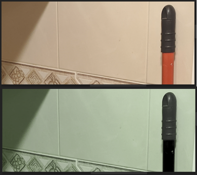

Hi, this is what I mean:
First picture is the original, below, the composite result (with black background) after keying the red color. As you can see, the red color is unique in that picture, the problem is, if I'm not wrong, all the different colors of that picture are a mix of Red, Green and Blue, if we are using the RGB profile. In a RGB profile, that kind of yellow in the wall is the sum of red + green. So, if I key the red color of the stick, that red color and its shades are removed from the entire picture, and I end up with a perfectly transparent stick (more or less) but a green color in the wall, because Yellow - Red = Green. I've learned that the only setting that avoids this whole red removing is the Range in color spill. If I lower the range, the yellow wall is not affected by the red removal of the key, and after some tweaks in all the other settings, I can perfectly manage to accomplish a perfect red keying, without the red of all the other colors being removed.
My question is... I haven't read any tutorial that says that I should first change the range, and then tweak all the other values. In my testing, this is exactly what I've done to get a wonderful almost perfect keying: first, you set the range, then you start tweaking everything else, using alpha channel and composite to see the results. Am I doing something wrong?

Yeah I can see that there is a lot of red in the original image.
The truth is that there is a lot of tweaking in these types of situations. And it's situational whether or not the best approach is a mask/rotoscoping, or creating a luma matte, or using color key. This doesn't look like an ideal situation for color keying to me, but if you can make it work, then you're doing it right!
I can't tell from the image what sort of movement you are dealing with in your scene, but if it's not a lot then a mask might even be better.

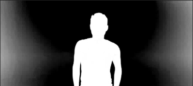

When doing your key, you can use the Alpha Channel output to see how precise your key is. Ideally your image is going to be black and white (just like a good luma matte). Anywhere that there are gray values in between black and white you are creating partial transparency. An example of a not-so-great background key here:

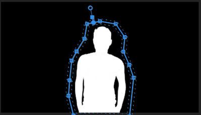

In this picture the subject is keyed pretty well, but the green screen is not keyed so great. You could further refine this with the Matte Generation settings as best you could, but what is also usually done in combination with a key is to create a "garbage matte," which is a loose mask that animates around the subject so that you don't need to worry about a perfect key everywhere.. just on the subject. Like in the image above, if I started losing my good key on the subject so that I could better key the rest of the screen, that would be rather pointless.
Garbage Matte:

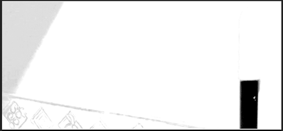

You can take the broom picture. What happens if you key the red color of the broom handle by adding an Ultra Key effect, select with the pen the red of the broom and apply?
Does the wall become green?
Can you touch any parameter, other than Range, to cancel the "remove all red from everywhere" effect?
Jul 29, 2020 Jul 29, 2020
Nope, I can't get a totally clean key from that image. I would not have tried to begin with aside from this experiment. If you use an animated garbage matte (as is the norm) then it wouldn't be too bad, though.
You aren't doing anything wrong with your key. It's just:
1) Use a Garbage Matte
2) You're limited in how much you can refine in Premiere Pro (it's editing software, not VFX software)
3) This is not a shot that's set up for success with chroma key. This is why VFX supervisors exist, and you will get better at doing it yourself if you keep experimenting. Separating images from backgrounds in video is not always an easy thing. There are various approaches and chroma key isn't going to be a magic, cure-all thing. Many times, even when something is chroma keyed, there's still a good deal of masking/rotoscoping involved. Some shots are 100% roto'd anyway. You've got to set it up so you have the best chances of getting a clean key, or for some other method to work well. You have pretty decent contrast here, for example. The new roto brush tool in After Effects might work pretty well for you if you want to be super automated. Again - I don't know what sort of movement you have going on here, but this looks like an object that's so simple that you could just mask it.
