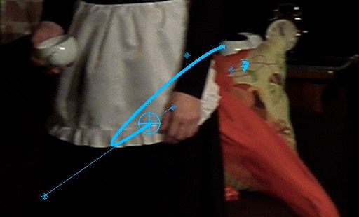

I had read the article.   In the clip I'm editing, I want to go from a distant shot to a two-shot.  What are the motion path guides telling me? What tells me I'm make the change smoother or more jarring?
Here's an example of one such guide.
Jan 18, 2025 Jan 18, 2025
I have no idea what kind of motion it represents in this particular shot.
All it shows you are going down and up again.
To make things smooth you use bezier keyframes.
the guide is for one clip only: it does not overlap from one clip to the next.
Practice on a static color matte first and get the idea behind the guides.
