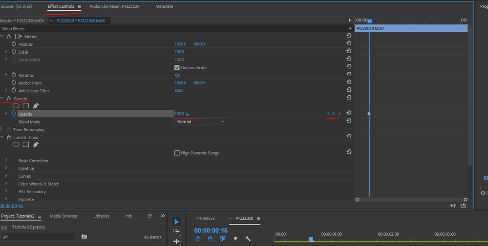

LEGEND ,
Mar 20, 2020 Mar 20, 2020
So ... I presume you can make the two lines of text.
And ... you got their backgrounds set? That's an option in the EGP below them ... just down lower through all the options available.
That completes work in the Essential Graphics panel, or EGP.
Now select the graphic clip in the timeline, with the playhead (that blue line thing) at the beginning of the clip ...
Then in the Effects Control Panel, or ECP ... use the Opacity effect.
Click the box ("Create a 4-point polygon mask")  under the Opacity effect to create a rectangular mask, size it to cover your text 'boxes'.
Set the feather for that Opacity effect to 0 to get a sharp edge as it 'reveals' the text under it.
Now move the playhead on the timeline to the point you want to start seeing the text, and add a keyframe using the little diamond in the ECP to the right of the line with a blue stopwatch and "Opacity".
Now move the playhead on the timeline to where you want to see the full text, and use the 'move' tool (V keyboard shortcut) to drag the mask off the text. This creates another keyframe there.
I would suggest learning how to use masks and keyframes ... this is basic and you'll need to understand how to do this a LOT.
Neil
