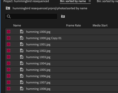

Then I selected the sorted images and copy-n-pasted them into the new bin (dragging them had the same result.) Here's how the new bin looked in List view (which is what I desired):
Then I switched to Icon View. Notice that the new bin condinued to display the images in the desired order in "list view sort".

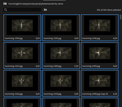

However, when I switched to "user order", the images showed in an entirely different (random) order.
Unfortunately, this screwed me up because it has no order for my purpose at all.

4. go to bin 'Sorted by name' (which happens to sit inside the bin 'Photos' if that matters). Set the view to icon view, set the sort order to User Order. Then paste what I copied.
5. Checked the files. They were in random order!
6. Within the bin 'Sorted by name', switched to List view. The files are in the correct order! But unfortunately, I can't manually change the order in that view. Hence my problem.
