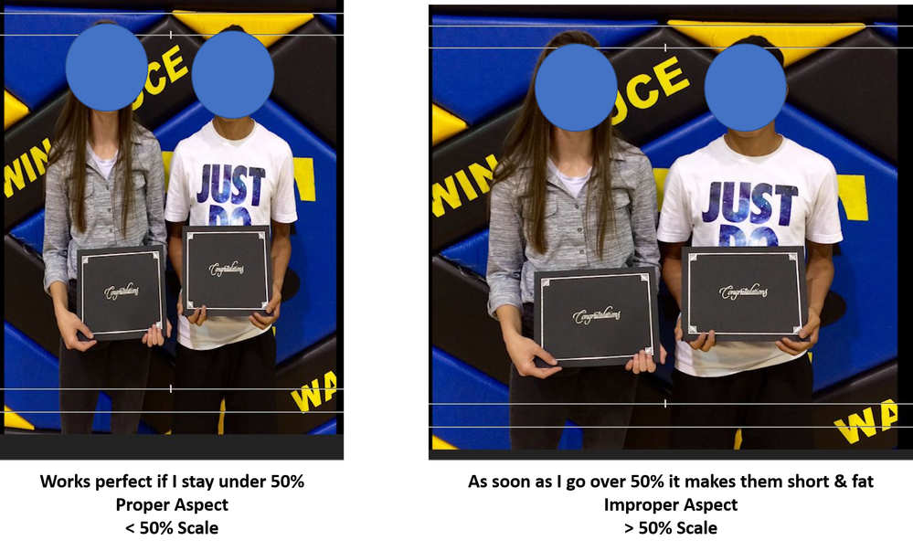

I'm having similar issues.  In PP, I'm trying to zoom in on a picture using Effect Controls\Motion\Scale.  Without any other effects on this clip as soon as I go over 50% zoom the people in the picture become short and fat.  I don't know why this is doing this in my timeline.  It's only a collection of files.  Most of the files are 2448 x 3264 (1.0).  The sequence settings are set at 1440 x 1080.  In over 20 years of working with PP, I've never had the scale give me issues like this.  I also tried adding a crop effect and zooming in using Effect Controls\Motion\Scale and it gives me weird green bars where I cropped.Aspect ratio issues with zooming - motion_scale.png
